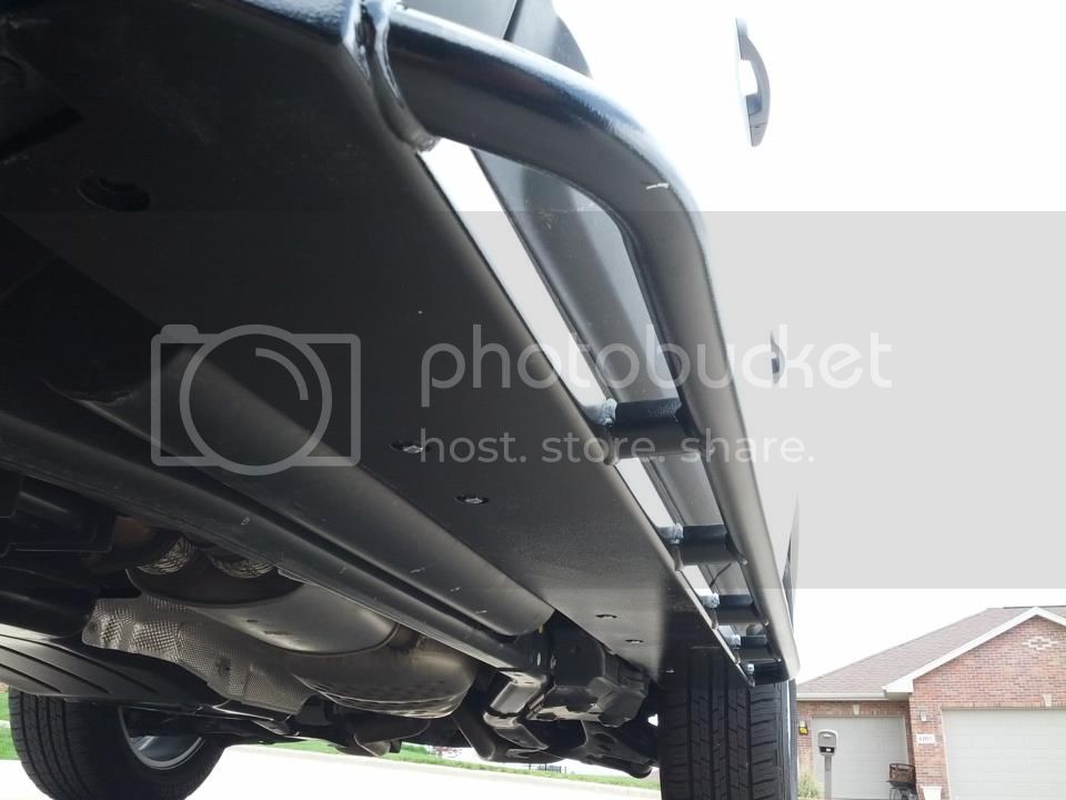

They say they stop the tire from coming up in your floor on a head on. I still have mine on the floor in the garage, but I have RS Sliders which will stop the tire movement back. Those frame horns are welded to the frame on a 2008 up.
The sliders are attached to the body, not the frame. I doubt they would serve the same function as the frame horn.

I don't think that's correct...
Well, they do on my voyager sliders. The door sill and underside of the sill.
The frame is further in.
Thanks, I know where the frame is!
The RS Sliders are way different. They install via 7 mounting locations per side including 2 pylon mounts each side. They go all the way over the frame rail on either side, protecting the EAS compressor and tank.
Worth the $$

Just do what you did... Here's a better picture of the full sliders..
http://www. disco3. co.uk/gallery/displayimage.php?album=23182&pos=8
