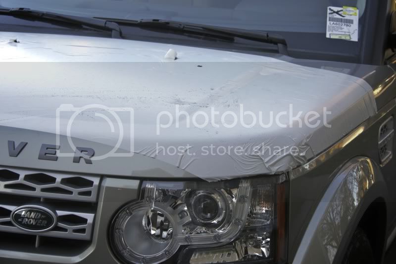

If you read "Wash After Service" you know I just will not let dealer touch paint on any vehicle I own. So I took LR4 home with plastic intact, 6 miles on clock at delivery, drove 13 more home and went to work.
Wheels Cleaned with Wolf's Deironizer
Tires/wheel wells cleaned with Adam’s APC
Wash Chemical Guys Citrus Wash
Remove plastic film and adhesive (3m General Adhesive Cleaner)
Iron-x
Very Fine Clay with Dodo Born Slippy Lube not much seen here either.
Wash again Chemical Guys Citrus Wash.

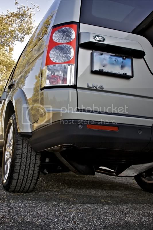

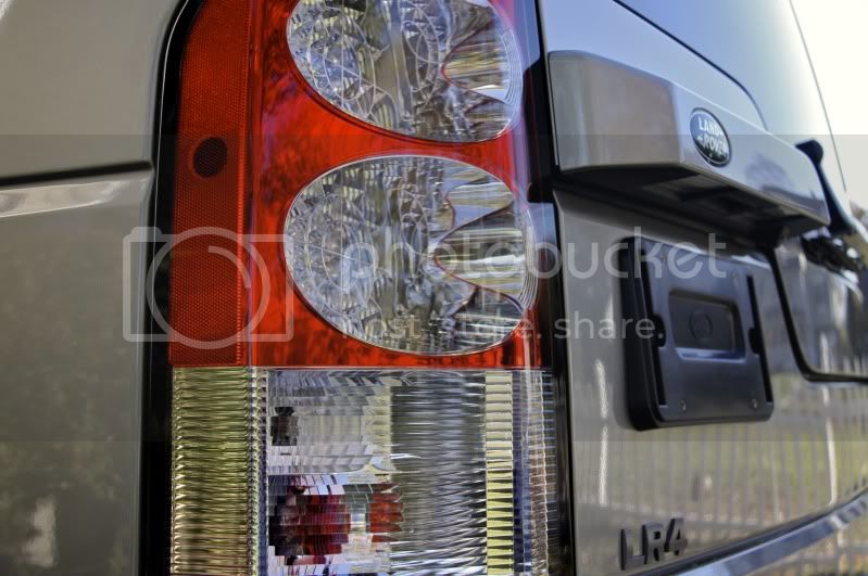

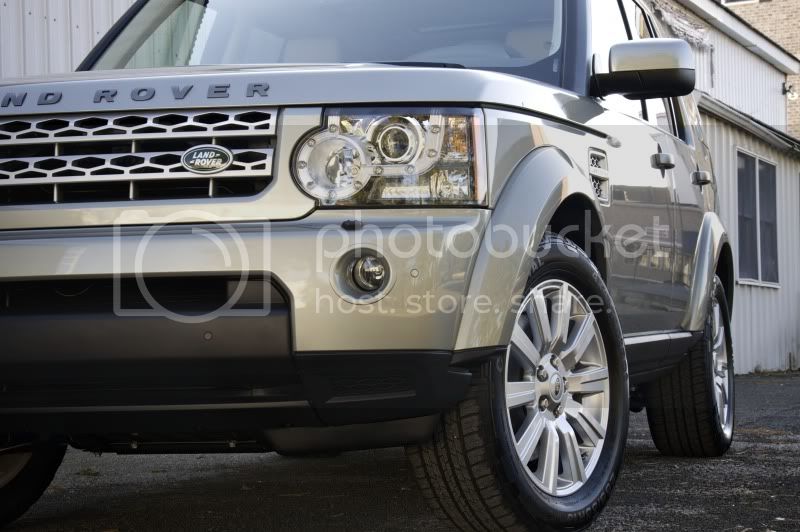

Finished Product:
