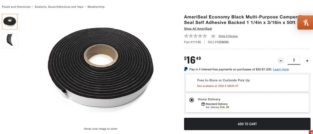

I bought the pack from Atlantic British, and installed. However I also put weather stripping around the edges and that really snugged it up to the metal. Now there is almost 0 movement in the a-pillars and no highway speed noise whatsoever. Here is the weather stripping I used -
Very nice - Thanks.
