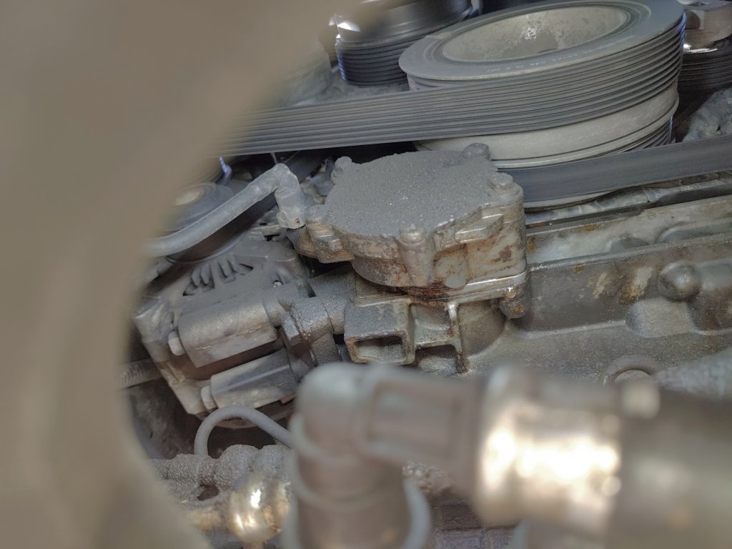

At about 100K miles we broke down on a dark rainy night because the serpentine belt failed (I had the kids with me). The belt failure was caused by a failed idler bearing (this is the idler that you can't see which faces in the opposite direction to all other pulleys). The failing of the belt took out some of the cooling system and given these engines propensity to head warping if they overheat this whole affair could have been disastrous...
So, my 2cents based on a hard lesson learned is yes spend the $$$ as it's relatively low when compared to buying a new engine; buy OEM, in my case they lasted a 100K miles! I have the V8, not sure what you have but here are some parts I have recorded (my rough notes so please double check for your engine):
  • The broken idler (the bracket I think is OK)
    • LR035555 ($211 at Lake Bluff)
    • LR010725 is the pulley ($50)
  • Bolt for the same idler
    • Not seeing this yet, not needed if we buy the bracket!
  • The other idler (preventative - above the alternator)
    • LR106769 ($48 at Lake Bluff)
  • The pulley on the belt tensioner (has a slight nick)
    • LR071035G ($167 at British Atlantic, $145 at Lake Bluff)
  • New serpentine belt
    • LR190101 ($37 at Lake Bluff)
  • New viscous fan pulley belt
    • LR012663 ($39 at Lake Bluff)
  • New viscous fan pulley (spotted a little damage on it)
    • LR012624 ($95 at Lake Bluff)

No noises, in hindsight had I known I suspect checking for bearing play may have revealed the issue! So, what I might do now is release the tension on the belt and then just check if there's any play in any of the idlers, it should be pretty quick to do this. Clearing up from this mess I found a bunch of ball bearings under the vacuum pump!
