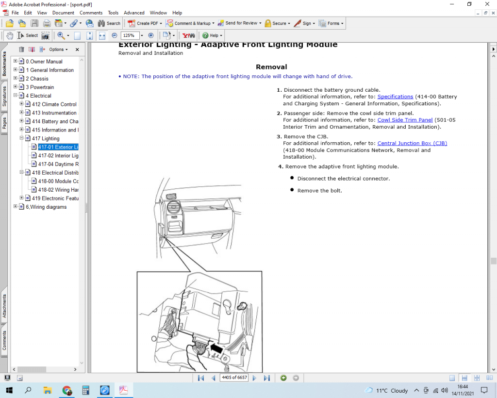

I need to replace the AFS Headlight module. YWC 500 610; but cannot find its location. The workshop manual shows it near the CJB under the hood near the battery, but I cannot locate it. Any help would be appreciated. 2007 Range Rover Sport Supercharged fitted with Xenon headlamps
Fitter14
Jun 23, 2021
Staffordshire
Hi, my manual shows it as being in the passenger side near the CJB.
