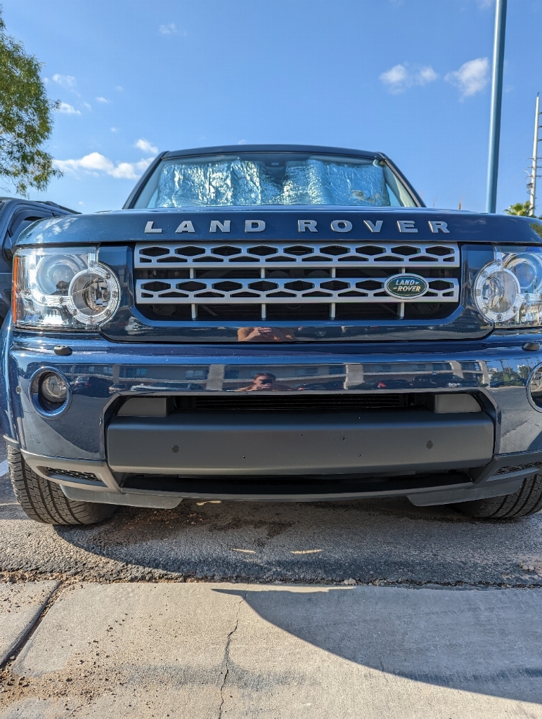

My 2012 drivers side headlight is blinking on/off at 100k mi. The replacement process looks well thought out and doesn't require tools. Pretty nice, although I haven't replaced the bulbs yet lol. Search results were showing people with bad bulbs. I was going with the Sylvania D3S linked here and replace both bulbs.

Having a similar situation on my 2012. My son pulled in the driveway last night and I noticed the drivers side headlight was out... After dinner I went outside to check it out, and when I started the car, it worked fine. This morning, when he went to school, the light came on when he started the car, but after about 1 minute of it warming up, it went out. Not sure if I would call that "blinking", but does that sound similar to what you experienced? Hoping the repair is just a bulb swap and not something electrical.
