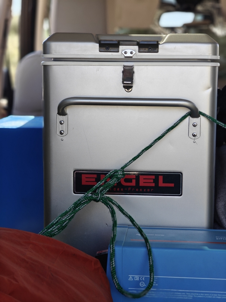

Are you set on the slider? I put my refer in through the passenger door or through the tailgate if I don't need to load gas and water cans. Then I simply tie it down. Its a bit heavy but taking out the water makes it a lot more comfortable. I didn't want the slider mount because it would get in the way.
