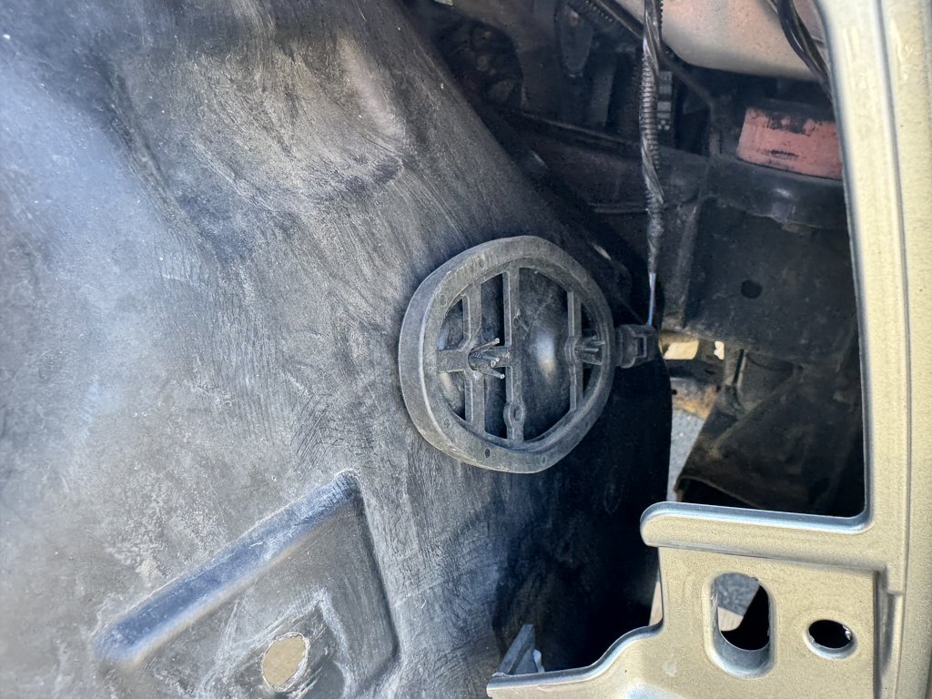

The antenna described on the back side of the wheel well liner is attached with the two Phillips screws on the front side of the liner. If you don’t loosen those you may pull the antenna out accidentally so be aware (pics attached)

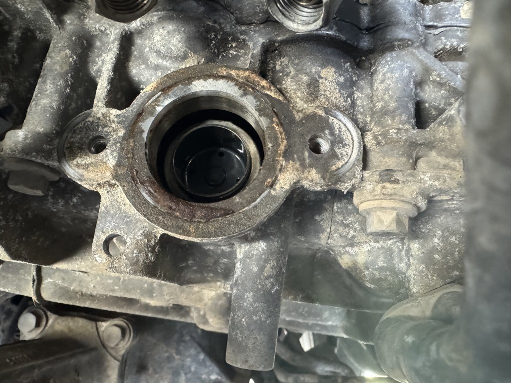

Once I got the pumps out I was surprised how dirty the mounting surface is.
The seal (P.S. you don’t need the “extra” washer that sometimes pops up in the “you might also need this” section when you are buying the pumps, they come pre-installed) contacts the inside of the block, not on the vertical surface but I chose to clean up that area with a bit of wet 1000 grit sand paper anyway.

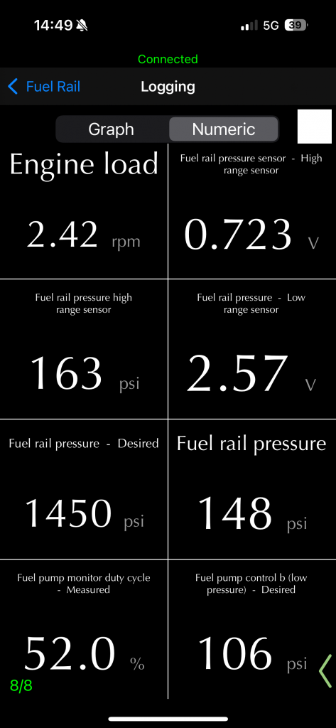

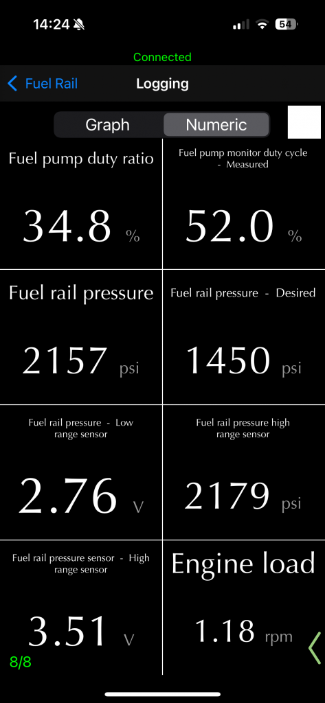

Happy to answer any questions to make it easier for the next guy. Truck started right up after the swap I’ll post my GAP tool screen shots below.

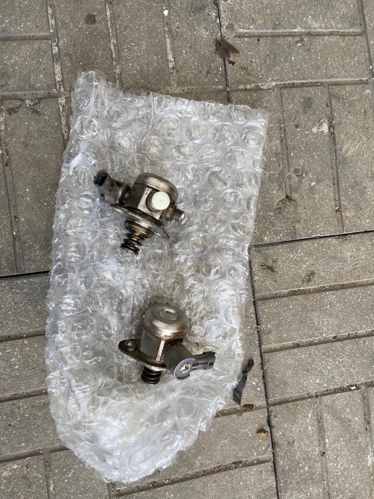

That said, my HPFPs looked pretty good - better than I expected:

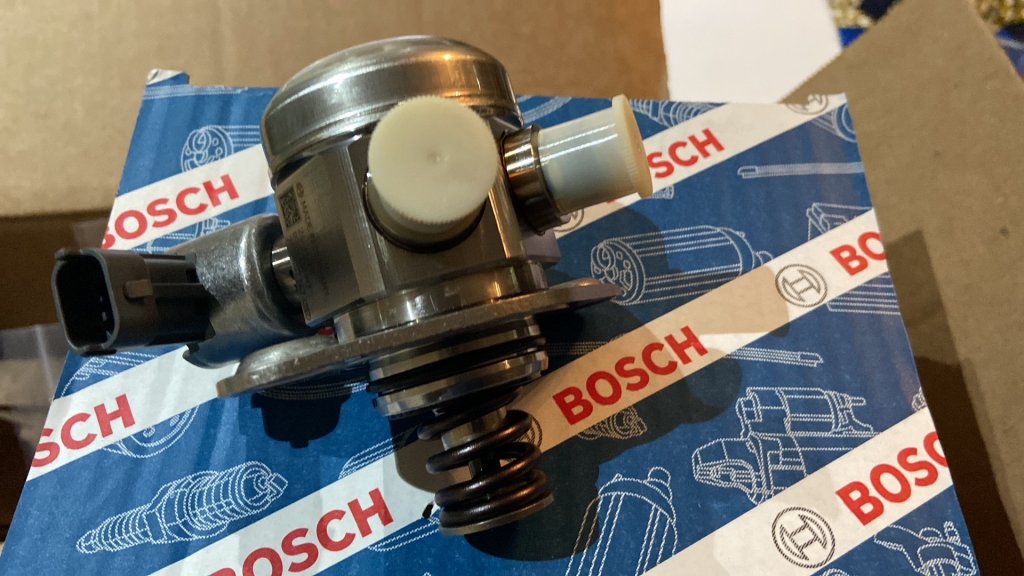

And the new ones before install:

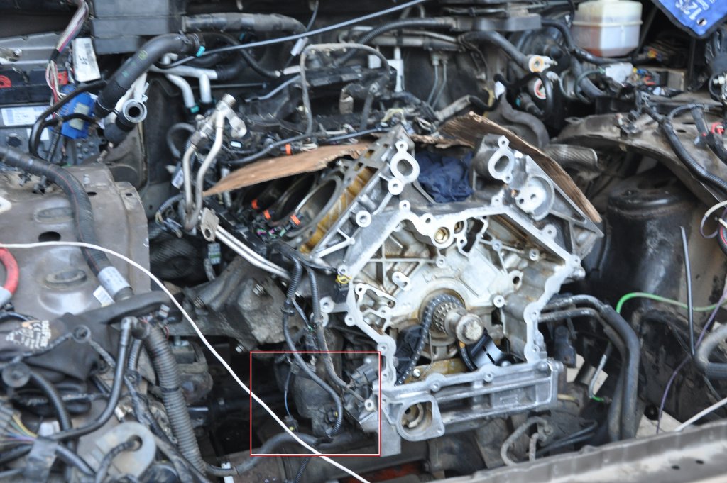

For Us, this job was far, far simpler since we already had the whole engine bay torn down so for those curious where the pumps are on the engine (underneath their black protective hood/covers) and what it looks like - check out the box I drew indicating their location:
