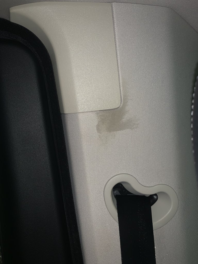

Anyone have any thoughts about where this B pillar leak may be coming from? I just happened for the first time during a massive downpour...

first thing to check is the sunroof drains,at the roof. maybe clogged, pooling water in the headliner.
