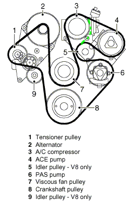

belt
Moose
Mar 12, 2004
1,082
Yup! :)
The green is how to route the belt if you do NOT have ACE.
B
bruce
Guest
thank you very much. i have been wrestling with this for a while, guess i should have paid a little closer attention before i removed it.
