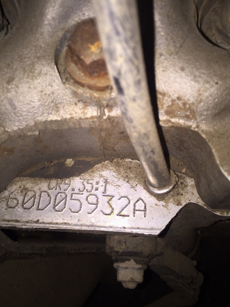

    [​IMG]
    So I guess this is a 4.0 ?
    BeemerNut likes this.

    Looks like a keeper to me being a 4.6, 9.35 CR as long as the cylinder liners haven't been slipping up and down with no cracks in the block behind the liners.
    Future top hat project?.....~~=o&o>.....
    superrocco16v likes this.

    Yes so is a 4.6, this is the donor for my lr2
