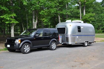

You'll be happy with the Prodigy controller. I went ahead and mounted the controller bracket to the panel just above my right knee. Yes, I made holes, but I was able to snake the wire through the void behind the steering column ....
