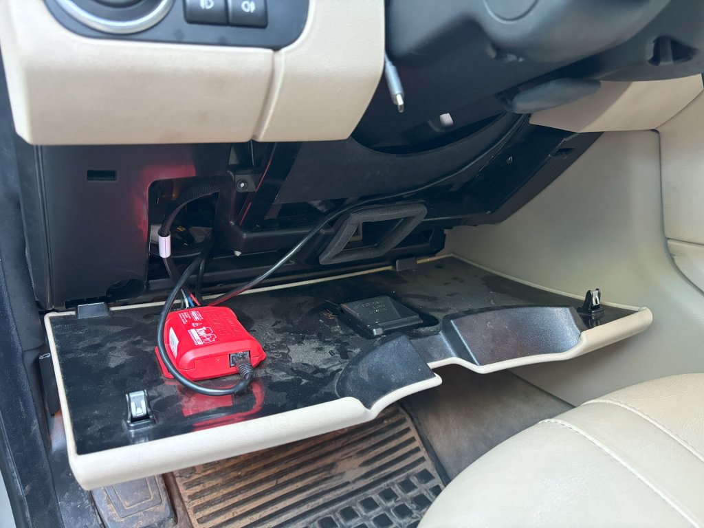

You can do a 'stealth' install of the redarc, it fits in the cutout behind the 'shin plate' under the steering, you can then snake the wire for the remote button anywhere you like.

Here's how I have my redarc controller mounted:
For now the control knob is taped to the steering column. It's not the best of places tbh, but it didn't require drilling holes in the dash. Current plan is to mount it to the headlight switch assembly, though I'd prefer it were more centrally mounted (so that in a pinch the passenger could reach it) - the idea of trying to control trailer sway by taking a hand off the wheel is a bit frightening.

I just did the same with a Redarc to handle a Micro Minnie over the 4th. But I said THWI and used a hole saw to mount the button in that panel after disassembling an area on the right side trim hoping to find a suitable spot. I didn't.
