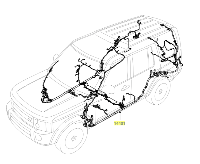

After digging around the internet for an hour or so today, I did find some harness info which I'll update in the main post.

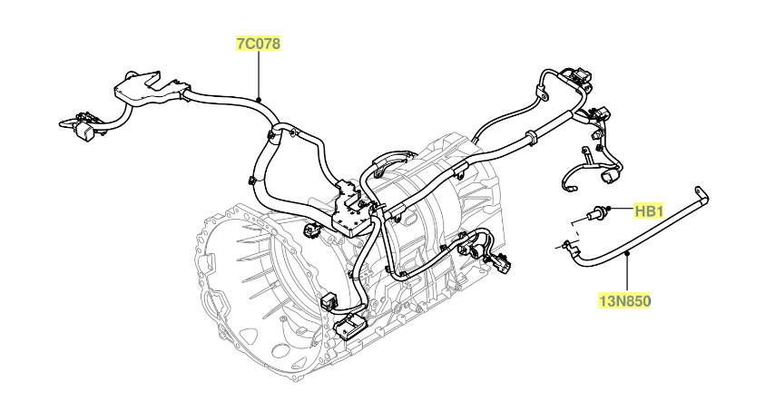

It does appear that the 2 speed transfer case uses a different trans harness than the 1 speed. I was kinda hoping the plug was just capped off. But thankfully this is just a sub-harness and can be replaced easy enough.
8 Speed Transmission harnness with 2 Speed Transfer case: LR053087 or LR053088

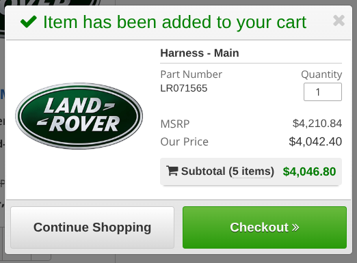

As for the harness with the Rear Axle Locker plugs... that's a bit more complicated. That it seems is integrated into the body harness.
Main Harness w/Locking: LR071565
Non Locking: LR071566
Unknown: LR071567, LR071568

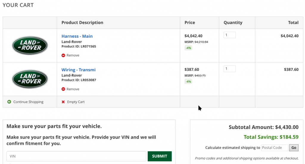

Apparently they're still available through the dealership network! ;)
(NO, I'm not actually buying one new)
The problem I'm facing now is similar to above, converting the Catalogue/Retail Part Number with the Engineering/Production Part Number that will be labeled on the part that a Salvage Yard will have access to.
Land Rover must have an EPC, but I'm guessing it's only for dealers and approved 3rd party shops.
