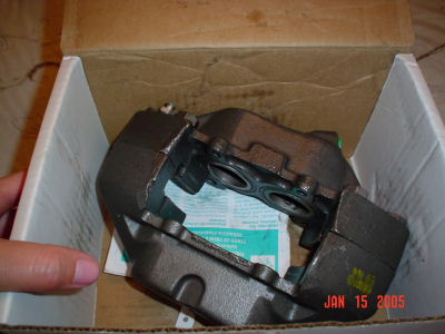

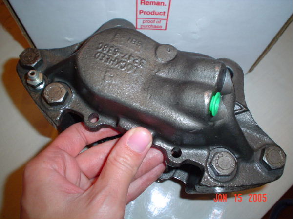

Yes I really do have a caliper for sale. Make me an offer @ this point I just want to get it out of my sight. I attached a picture for your ready review.
"I'm in the USAF, I live in base housing"
Maybe I need to re-think the whole JAG thing after all? That is extremely commendable and admirable that you are serving our country despite the turmoil. Be safe.
Let me know on the caliper. Which side has the problem?

That is one beautiful caliper. I need a left (driver's) one, at least...I haven't looked at the pax side yet.
I attempted to PM you earlier, but do not have that ability yet. You can email me at [email protected]
Thanks,
Lendawg
