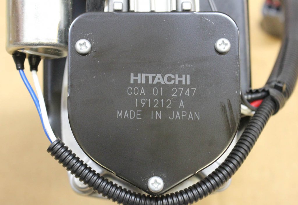

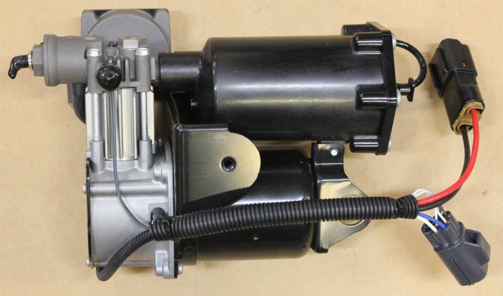

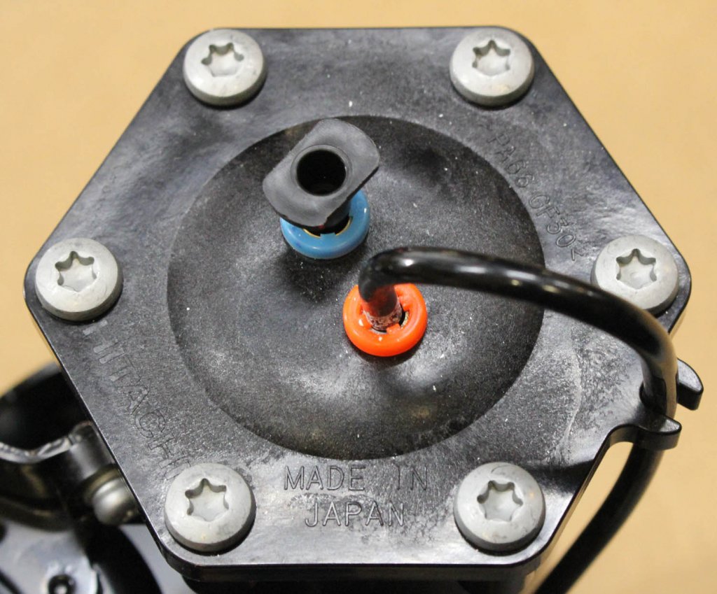

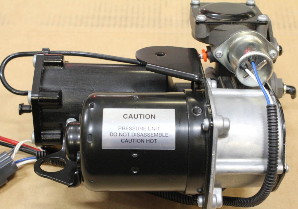

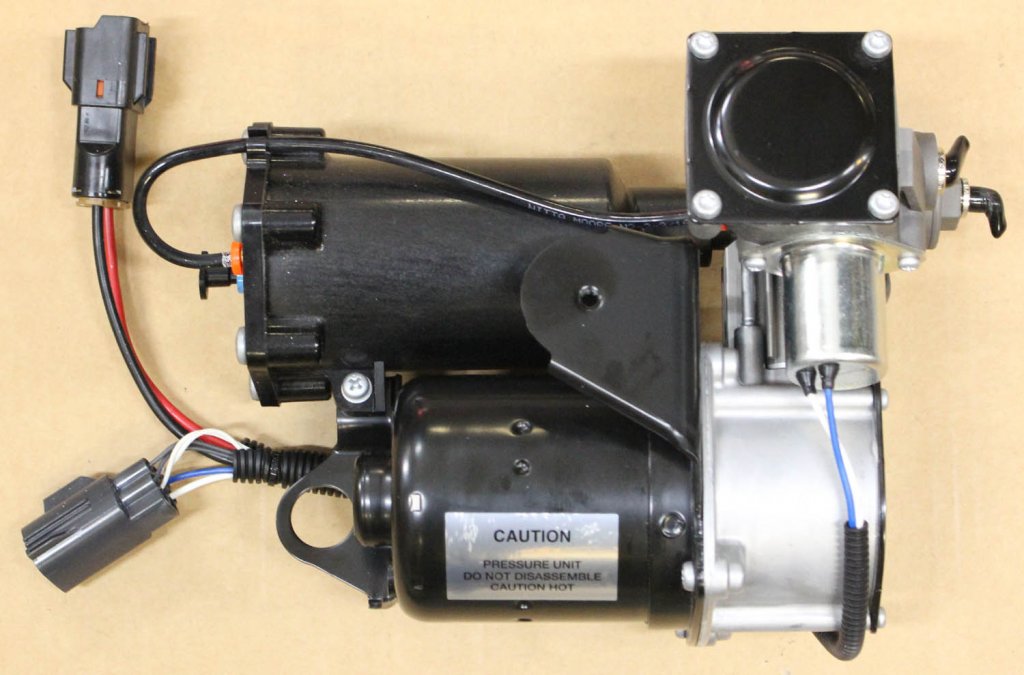

There weren't many detailed photos of the Hitachi, so I took some pics of my new one. ~$600 delivered from RM European. The AMK looks completely different.
https://www.rmeuropean.com/Products/LR072537-MFG476.aspx
Hitachi CMP0001, equivalent to LR # LR072537 or LR023964, metal mounting bracket with rubber isolators NOT included:
Hitachi_CMP0001_03.jpg Hitachi_CMP0001_04.jpg Hitachi_CMP0001_05.jpg Hitachi_CMP0001_08.jpg Hitachi_CMP0001_09.jpg

Yup. Best I could tell, there was no significant advantage to the AMK, and the AMK required some re-plumbing (not a big deal, but a nuisance). Sounded like LR switched from Hitachi to AMK due to manufacturing supply constraints during LR4 production? Possibly due to factory shutdown related to a tsunami circa 2012?
My original Hitachi lasted 10 years / 125kmi and the dessicant beads were still 95% intact. I'm tempted to try rebuilding it, since about the only thing that might be wrong is the piston ring may be worn slightly. Bench tests identical to new. But I didn't want to **** several more hours and $100 on a repair kit and possibly have the same problem afterwards...
