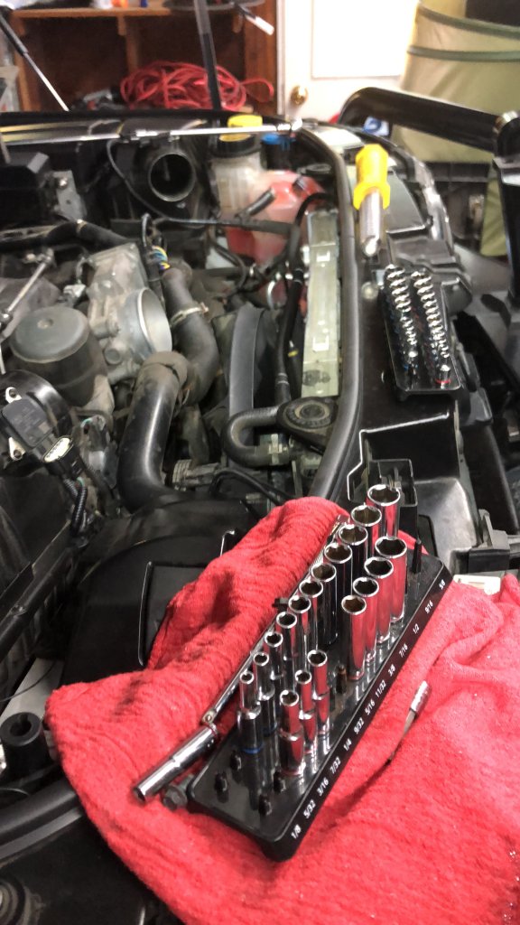

In the shop now for water pump replacement. The Bleeder plug cracked on extraction from the crossover pipe. that took a trip to LR pasadena for a tiny (but still $13) plug. Joy. But you can definitely see how brittle all the plastic is on that pipe. all the heat can't be good for hard plastics. You would think an engineer would know that.
