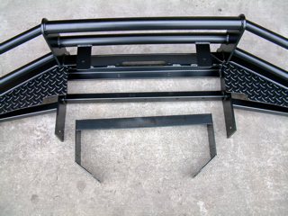

Nick,
This is how we built my bumper so that I could hook it staight to the frame.
Mike

Thank you brotha, I just saved it in My Pictures for future refrence. I'll probably hit the drawing board this weekend.
By the way... do you have a good picture of your rear bumper installed? I think I saw one picture that looked like you cut off part of the lower quarter pannel, but I can't remember for sure. After I take care of the front the rear will come next. I don't know from experience, but from the looks of things the rear end of these vechicles seem to be a potentail clearance trouble spot due to the way the rear hangs soo far off the axel.
