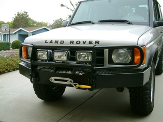

The 751's are hd OME springs made for a D1 that work really well for a D2, I bought them at, https://www.expeditionexchange.com/ome/
Take a look at the info.
I like your idea of building your own bumper, gives you that one of a kind feeling.

Nick,
What ever you do with the front bumper don't anchor to the cruch cans, go straight to the frame.
