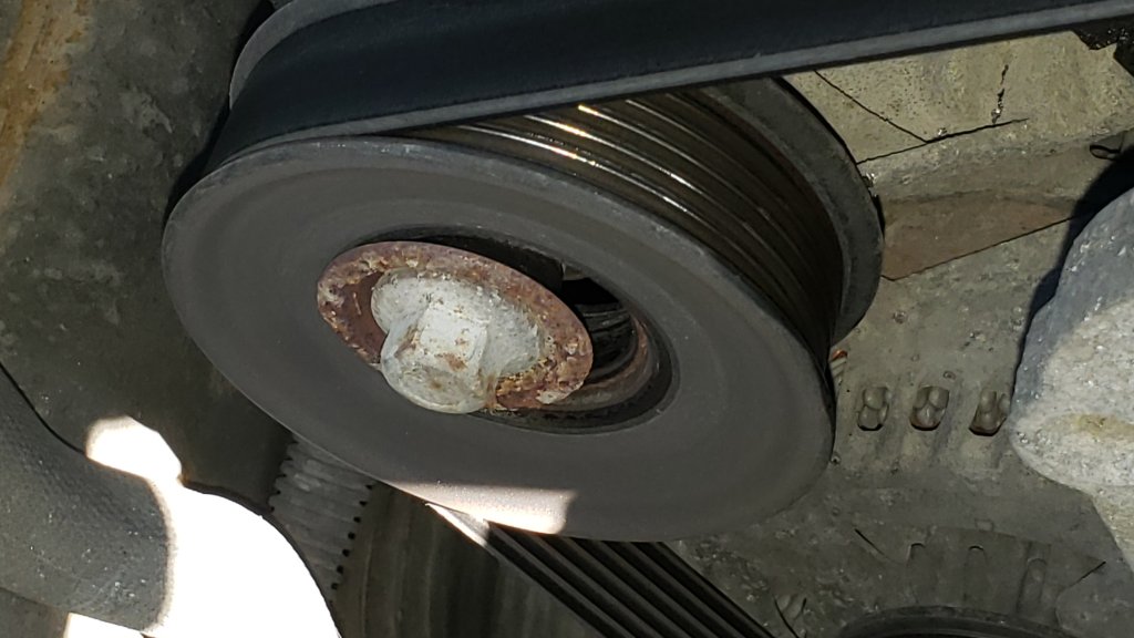

Found the problem!
The RH upper idler pulley bearing is shot.
Its totally off centre with just the belt tension holding it on
