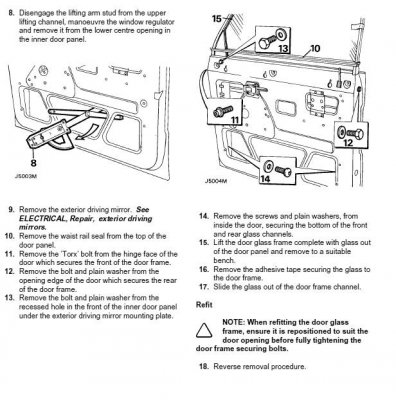

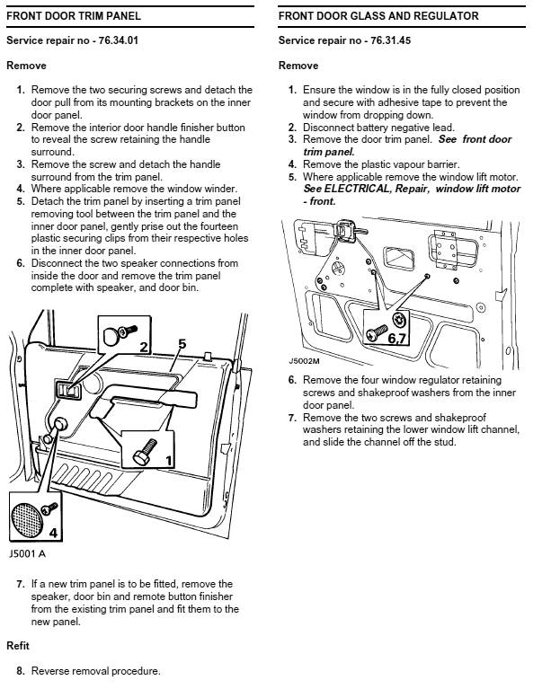

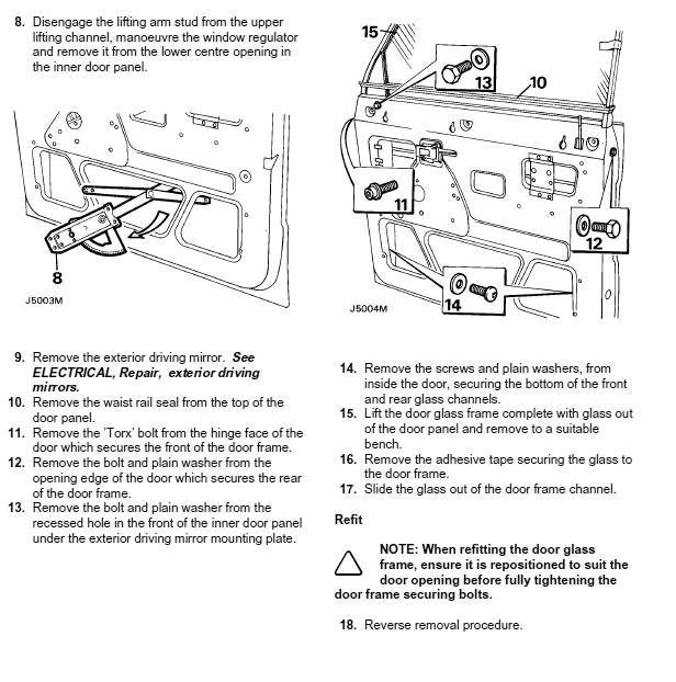

Hi guys I'm having a little trouble removing my door panel on a discovery 2 series 2000 any tips I have the screws out of the handle but not sure where to go from there??? id appreciate it !!! : )
