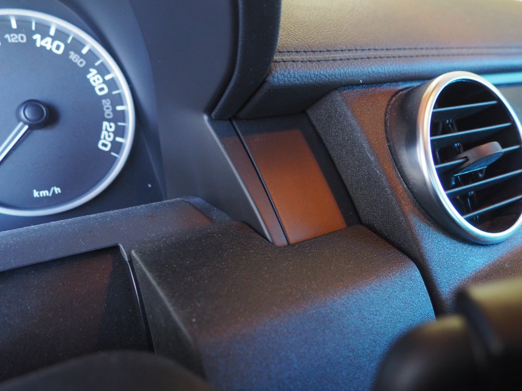

I considered using a spot right to the instrument cluster but I'm not sure if it would fit properly there and I also plan on putting the aux fuel tank gauge and pump switch there instead
this is the spot I'm talking about:

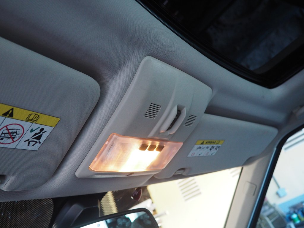

I also considered the plastic cover of the sunroof/ambient lights, but I need at least 3 switches, ideally 4 to fit there
This is the cover I'm talking about:
Trouble is, it'll have to fit 4 switches and the cover is white, I'm not really into sticking black switches up there.

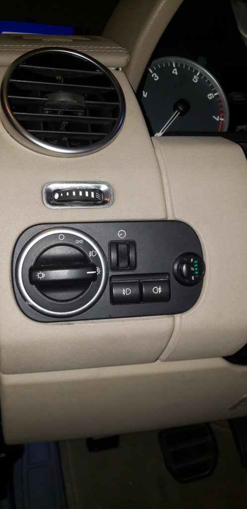

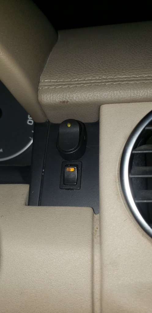

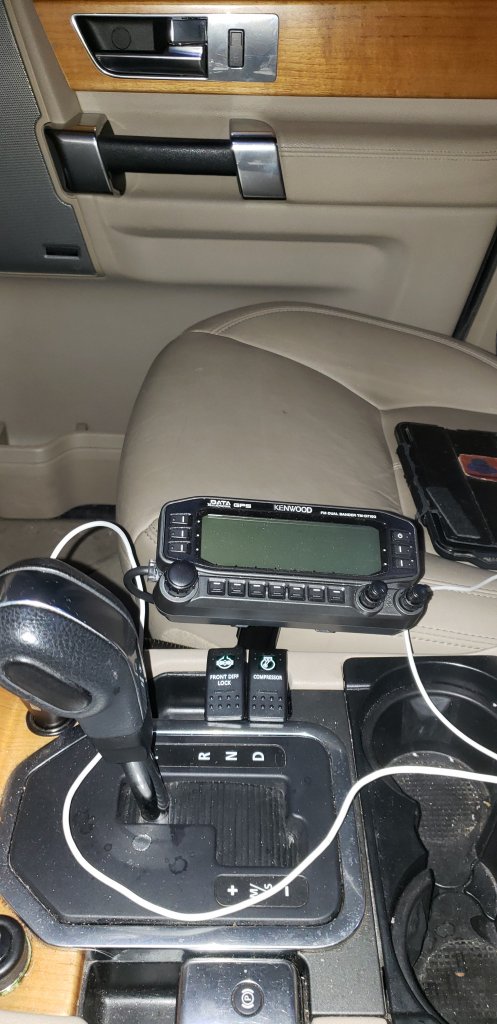

Not saying it's ideal, but here is what I did if it helps you decide.
Cell phone booster and traxide dual battery switch.
Auxiliary gas tank switch.
Off-road light switch.
Compressor and front locker switches

thanks, it did help a lot. I might use the place where you put the traxxide and cell phone booster switch to mount the aux tank gauge/switch (since I'll be fabricating my own and I have no idea where I can find one like yours).
I also decided to use the light/sunroof plastic housing to mount the switches.
I took it off yesterday and realized that I can replace the mic position and use the sides to mount two or three switches on each side.
I found a dirt-cheap panel, complete with switch, mic and lights for BRL50, I'll be modding that one and keeping the original for when I want to sell the car.
