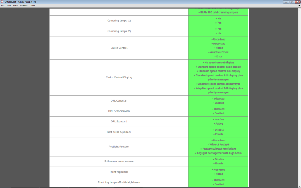

I don't think anyone has ever tried to turn the DRL LED lights off on the 2014+ before.
You could try buying the GAP IID tool and see if you can disable them that way, but there's no guarantee it will work. I suppose you can email them and ask (they are very helpful) before you buy.

LR is notorious for making random changes - some identical features that can be changed without a dealer on my 08 LR3 cannot be done on my 08 RR and vice-versa. Really makes no sense to me. The 15 manual does not show any process, it just says to contact the dealer. You could show them this and then have them "figure it out" on their dime before scheduling the service - should only take 5-10 min if they know the proceedure, although they may have a min charge if no other services are being performed.
It does look like you can turn it off with an IIDTool if you are inclined to purchase one.

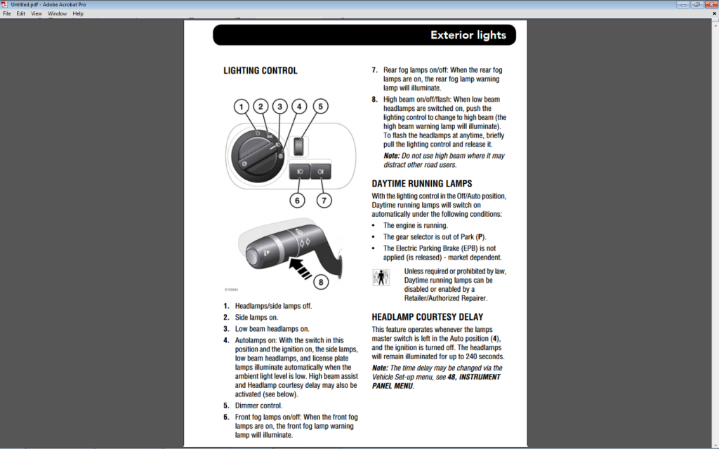

Thanks to all for the great feedback!
Has anyone tried this on their 2016 LR4 w/factory DRL (does it work):
http://www.ownerinfo.landrover.com/document/LS/2016/T19947/18742_en_GBR/proc/G1801525
As has been pointed out above, I found the 2015 LR4 manual link and it's different*:
http://www.ownerinfo.landrover.com/model/LS/2015/document/18970_en_GBR?section=T19947
*Unless required or prohibited by law, Daytime running lamps can be disabled or enabled by a Retailer/Authorized Repairer.
