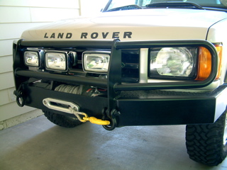

Andy,
How about a heavy duty winch bumper, 2x6 box steel, extra sub frame and no crunch cans. This has stopped lots of damage for me already.
I believ we put just less than $200.00 in materials into this, plus of course the winch.

Mike, I may have to give you a call sometime this summer to discuss your plans. The real problem I am having in the "design" phase is connecting the "here's what I want" with the "this is the size and length of steel to get."
Can you email/PM me your number so we can talk? Unless of course you're one of those "here is the bumper I built, but no one gets to know how I made it" folks from POR. :biggrin:
