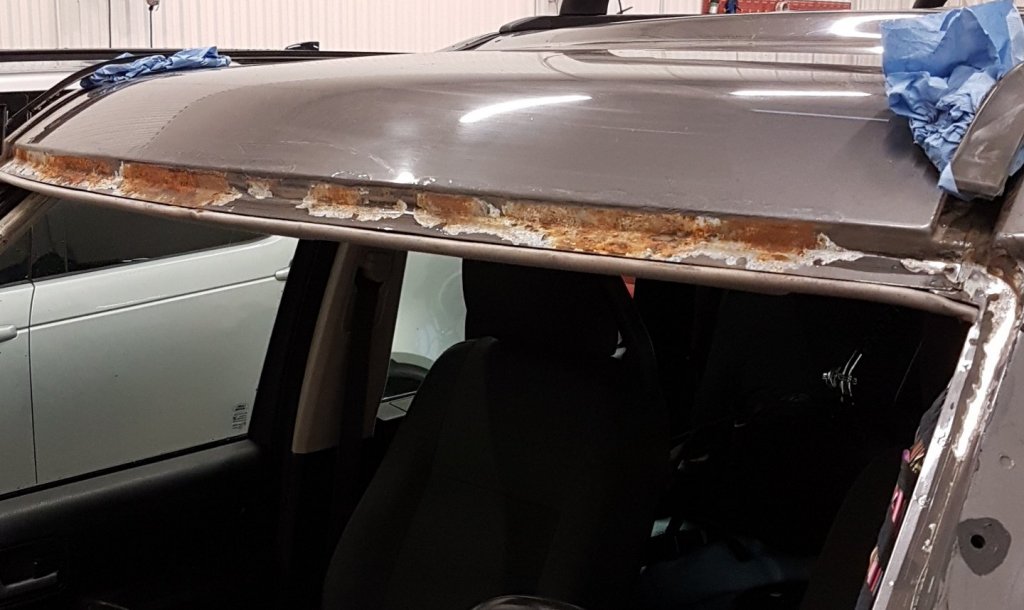

I have been experiencing wet carpets on my 2005 LR3. After plugging the holes on both sides of the windshield without matters improving I took it to a shop. They pressurized the car and applied foam to the windows, and saw bubbles coming out from the top. They then removed the windshield. This is what they found:
PS: It is apparently possible to pressurize a Land Rover, despite all jokes about cats escaping with the doors closed..
