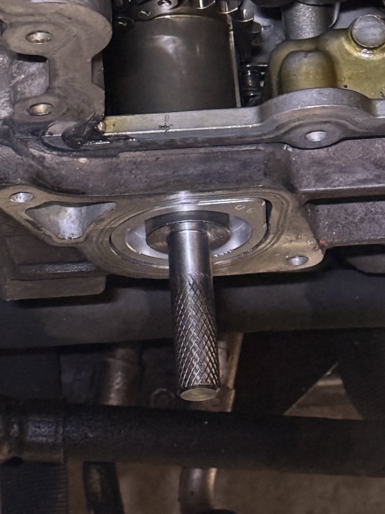

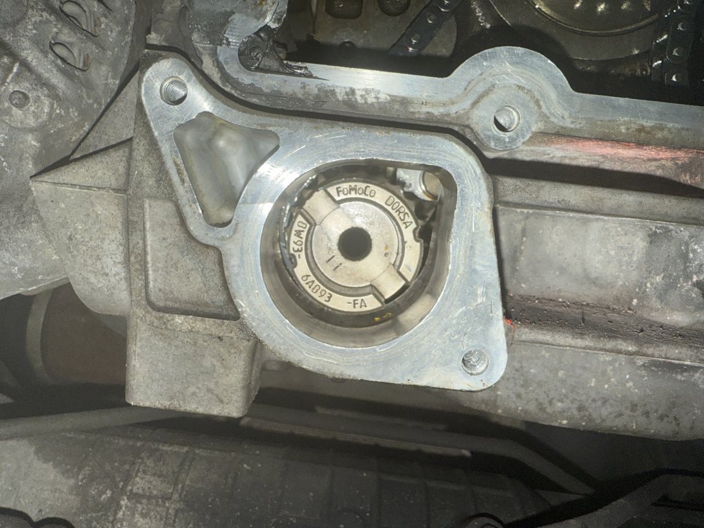

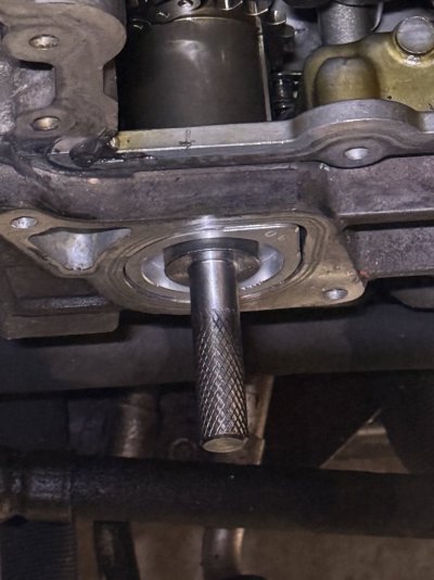

For me the cam gear that runs the hpfps was out of timing by almost 180 degrees. I ended up removing the vacuum pump and front cover to expose the chains. I then pulled the AUX chain tensioner back removed the guide on the passenger side. I then was able to put a crow bar wrapped with a sock on the ended to protect the cam gear and put it in the slot of the cam gear and rotated that while taking tension off the chain with the tensioner.
Made sure the fomoco writing was on the top side (see attached photos) and was able to use the cam gear alignment tool and see it was in alignment. Put the timing cover back on along with pulley and crank bolt vacuum pump etc and she started right up and is running great. There was no need for new hpfps or vacuum pump.
