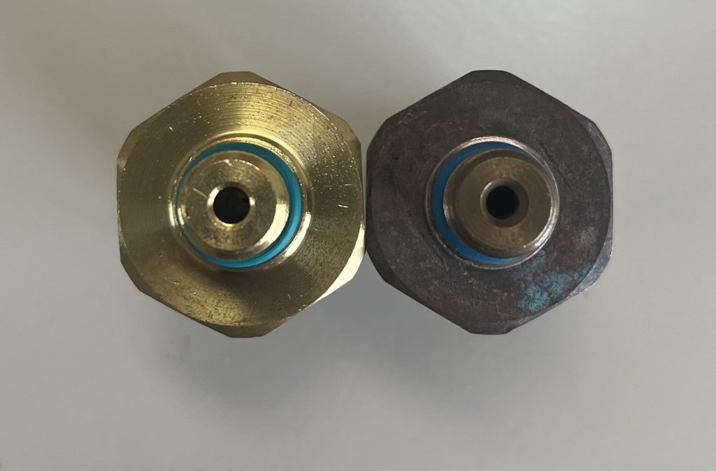

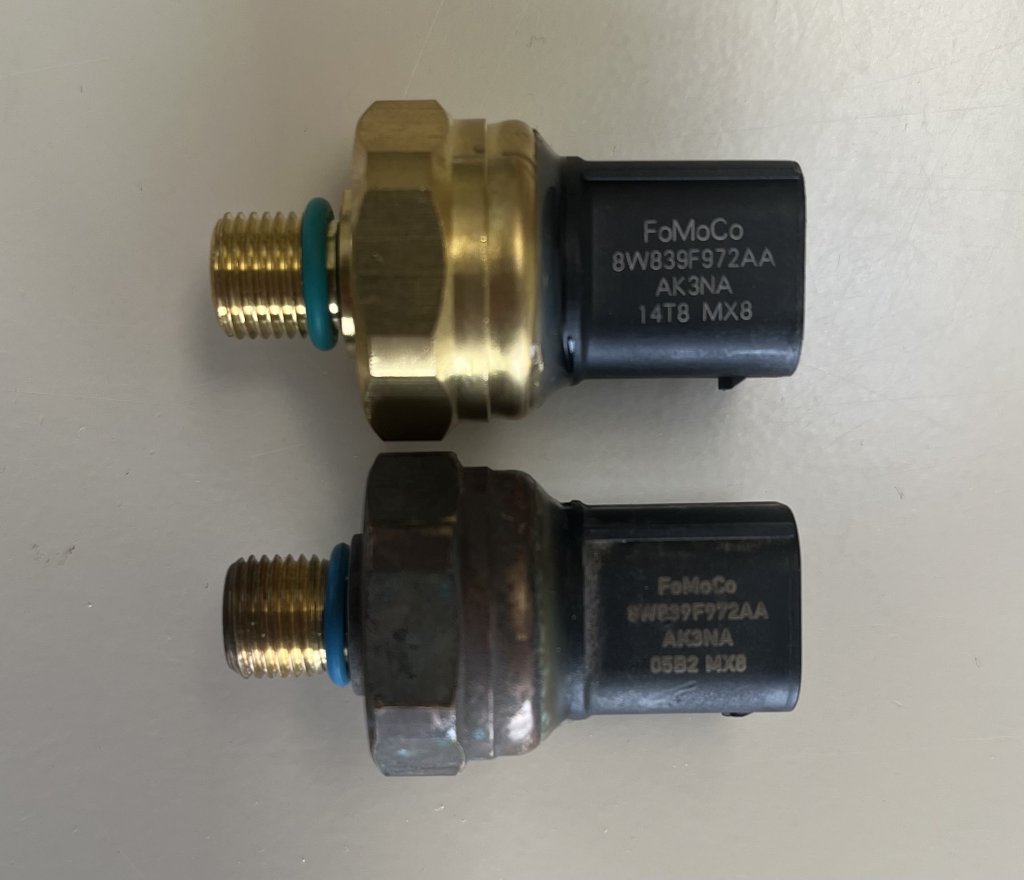

Very true! Here is a picture of the low pressure sensor side by side the factory one. You can see they look similar but not exactly the same. That’s where I was skeptical.
I did buy it off Amazon too as I wanted it asap in hopes to get my wife’s vehicle on the road sooner. Well that didn’t work out. I sure hope it was the right sensor and not the wrong one and my choice to go through Amazon for the quick fix isn’t what is screwing me all along.
In my research I actually found that part number for this sensor is actually the same sensor for the ecoboost from ford as well. Of course if you search land rover and this part number the sensor is anywhere from $30 to $50 for that sensor. If you search the ford ecoboost and that part number I saw it as low as $10. I found that interesting.
@gsxr I noticed your sensor look different than the ones I have. You had a clear/yellowish sensor housing and you also had an additional hole on the copper part. Also your bevel on the inner lip looked more like my factory one then what my new one had. I didn't think it would make much of a difference. What your take on that?
