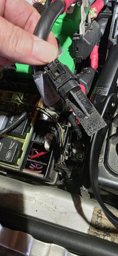

Today I did more digging and started reading about the high-amperage “mega fuses” (300A/400A). I also found a loose wire near the battery that I’m not sure where it’s supposed to connect—I’ll include a photo in this post.
That wire doesnt connect to anything. Was something that was used before delivery I think. We all have it.
txfromwi
Dec 18, 2013
667
379
That wire you are showing is used only in initial shipping from the factory. It connects to a battery disconnect relay that is installed at the factory and removed at the dealers. Make sure that cap is secure, it can sometimes come off.
There is a pyrotechnic coupling at the battery that disconnects the battery but the only way to make that fire is to deploy the airbags.
I have never heard of that activating all by itself.
