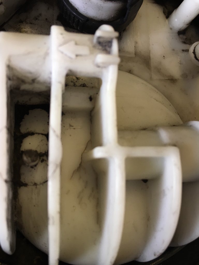

So I went under the car again and dropped the tank. Cleaned the top flange and all connections and saw a crack on the outlet port. Reconnected the fuel line and power to the tank, started the engine and sure enough it was spraying a fuel mist through the crack.
