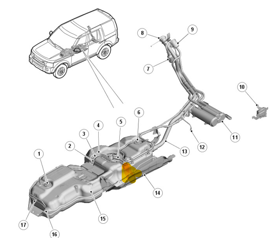

toddjb122, if you suspect the problem is coming from the top of the tank and you want to convince the shop tech, have them look under the car at side marked in orange on pic below, in my case the whole tank was dusty/dirty and there was a witness/flow mark (cleaner, darker) in that area as the fuel slowly cascaded down that path, that is also where the smell is the strongest. Also try to have them look at it when engine (fuel pump) running or just right after stopping it, so leaked fuel does not have time to fully evaporate.

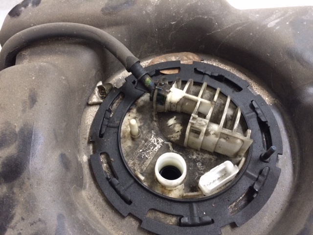

Finally! After the 4th request to a mechanic somebody listened to me and dropped the tank. I don't have it back yet, but the dealership is telling me "cracked apart fuel tank flange gasket."
Here's a photo. I think you are supposed to see the white flange extending evenly under the black ring, but it's all cracked apart/uneven on mine. That's an odd failure, but is an obvious one once a tech was able to look at it.

Damn. Great job sticking with it and working through it! Seems that it's getting resolved, finally.

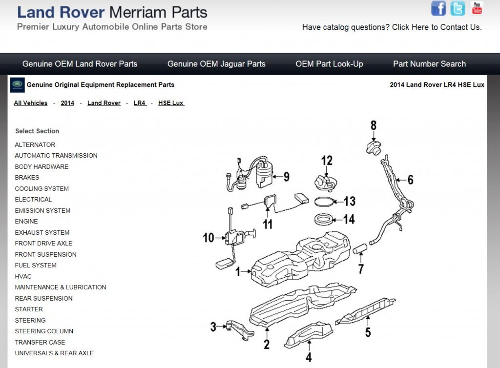

Nice work! Anyone capable of cross referencing fuel tank parts numbers to see if 2014's and later have the same parts installed?

Waterndirt, I use this site to view/order p/n's but there are many similar ones. It will allow you make the cross references you are looking for. At least the flange we are taking about here is the same p/n for the 2014 MY.
