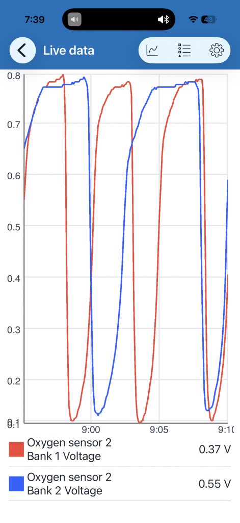

The only thing I looked at was #2 O2 sensor voltage.

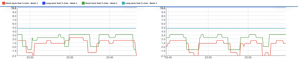

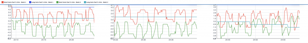

Thanks for the reply’s. Still no codes.
I captured fuel trims at idle (first image). And at 2k rpms (second image)
I’m not sure what to look for but I expected bank 1 and 2 to more closely mapped on the chart and think this means one bank is running more rich than the other

One thing I forgot to mention - engine needs to be warmed up so the car goes into closed-loop feedback fuel control to evaluate fuel trims. If it wasn’t warmed up, you’ll need to do this again with the engine warm. Same for o2 sensors. Also, when looking at o2 sensors in the context of fuel control issues, you generally want to focus on the lambda sensor, which is usually designated as sensor 1 on our LR4s, although whatever sensor you tested seems to be giving a nice wave form.
Turning to your fuel trims graphs, add long term to short term for a given bank to get the overall trim value. Positive is lean (positive means that the engine is adding fuel to compensate for the o2 sensors not seeing enough in the exhaust). Negative is rich (engine subtracting fuel). It looks like Bank 1 starts out around +11 to+13 at idle then drops to about +3.5 to +8 or so at higher rpm. Bank 2 looks like it starts out at +5 to +8 at idle, then drops into a range of somewhere from +1 to -5 at higher rpm. So both trending from lean to less lean (or even a little rich in Bank 2). Although “normal” range is said to be +/- 10, so none of these values are really too far out of wack.
(One caveat: With the lines split and tracking each other on a graph like this, it’s tough to tell if you might actually have two y-axis scales and one might be hidden. Some scanners will default to overlapping scales so that it shifts the lines of the graphs making it easier to see the lines. Look for some button or option to show all the y values, or if you can pull up a screen showing live values (just numbers, not the graphs), it might tell you whether the scale is the same for all the graph lines.)
Assuming the number are correct, trending from more lean to less lean as RPMs increase most often points to a vacuum leak. At idle, the unmetered air being sucked in accounts for more of the total volume of air being consumed by the engine, so the lean condition is more significant. When the RPMs are raised, more total air is being consumed and the amount that is unmetered (vacuum leak) is a smaller portion of the total, so the lean condition is not as significant. However, the leak would be a fairly small one with these numbers, but might be enough for a little pining or loss of fuel efficiency. If the PCV valve hasn’t been changed in a while, you could check it - but that usually gives a much bigger lean condition when it goes. Otherwise, maybe buy a cheap smoke tester off amazon and smoke test the intake plenum.

The attached is the O2 voltage at idle and warm. Originally I thought this might mean the bank 2 sensor is lazy as it doesn’t peak and drop, it plateaus.
That’s a good catch. could be a lazy sensor, but also could be a symptom of something in the fuel control system. bank 2 is also where you are seeing the short term fuel trim fluctuate into rich territory (even though overall fuel trim isn’t maybe that rich). i suppose a leaking injector might cause this too. hmmm, easier to swap out o2 sensors than injectors if you wanted to try it.

That was my thought too, switching the sensors and see if the problem moves.
