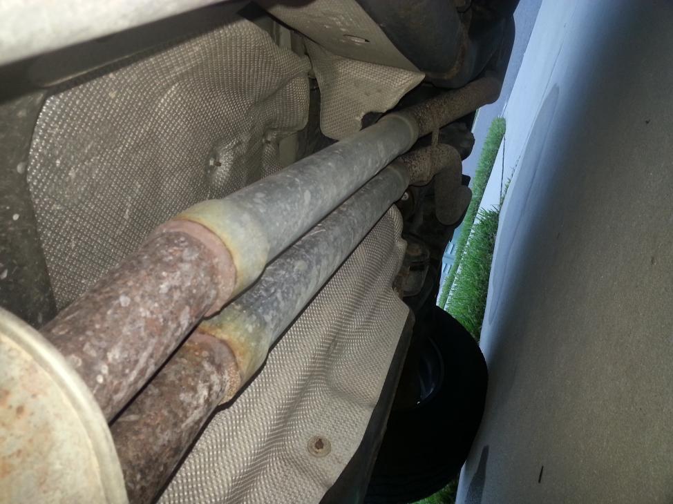

Glad to hear it! Everything is stock except I took it to a local and shady backwoods weld/muffler shop and they cut the big ugly muffler out leaving about 2 inches of pipe on the inlet and outlets of the muffler. In the mufflers place, they just welded in two stainless pipes.
It maybe took them an hour total once I pulled in to when I left. Total cost was only $60 if I remember correctly. Very cheap mod with great results in my opinion.
My apologies, I dont know why my phone wants to upload the picture sideways..

Sweet...will that effect emissions at all? Both in terms of the fault codes and the state-required testing?
How loud would you say it is, like as a multiplier of the stock sound?
Biagetti
Dec 23, 2012
201
I'm not 100% positive that it wont effect emissions but I wouldn't think so as long as we're not messing with the cat. I grew up and lived most of my life in Pennsylvania where we had state inspections and emissions testing, but living in Florida for the past 7 years or so where we dont have such a thing didn't make me worry about it.
I would call the local inspection stations as they should know, if you or someone were to do this.
As far as any fault codes, I haven't received any. I also haven't had any back pressure issues or negative effect on performance.
Loudness... tough one!
Let's think of an F150 with a typical afterarket dual exhaust. I would say that the Rover is quieter at idle, louder at heavier acceleration and about the same at cruising speeds. Make any sense? Haha
For the stock exhaust, I never really heard it. I heard the engine, but not the xhaust.
