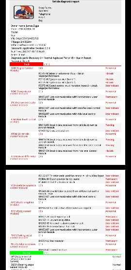

I have recently taken my 06 LR3 with 156xxx miles on it to get repairs done. But im being told that i need to get my HDC Module repaired/replaced. To many faults that all point to the HDC Module.
Has anyone got this repair done?

Nope. Sounds odd. Does it have any physical symptoms pointing at a bad HDC module?
What faults are present?

I dont think that pdf worked here is a screen shot.

The faults listed on your report does not point to the HDC module. Some of them are historic meaning it was stored in the ecu when it happened a while back. Clear all the codes first and see what faults come back which will signify current problems.

Also, where did you get this report?
...and again, what is your vehicle doing, physically???
