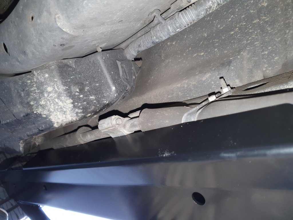

Firstly, the sliders come with a vertical 'fin' that tucks up underneath the frame of the car. However the 'AC' lines (I think that's what they are) run along the length of that frame and get in the way of where that fin should sit (photo below).
The obvious thought is to just cut the fin off along the length of the bend, but I'm wondering if this compromises the integrity of the slider? Also does anyone know how I would go about finding someone who can cut hd steel for me and then I assume I would need to re-powdercoat the cut (I'm in Los Angeles)?

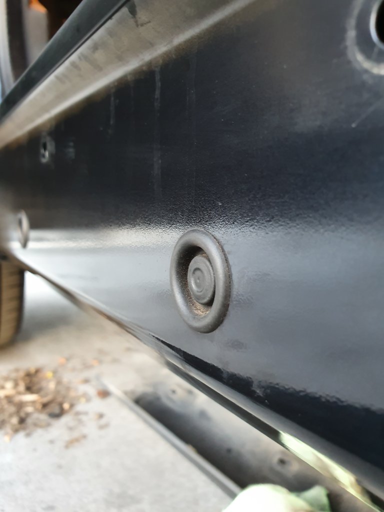

Thirdly, I have removed the little yellow plastic clips that held the plastic moulding in place, but do I have to remove the little black rubber inserts, (photo below) or are they fine to stay in place and provide a little buffer between the slider and the frame?

Those body grommets are most likely very important to leave which keep water out of the cavity behind them. I would NOT remove those.

That vertical section you mention is likely inherent to its strength and sounds like a dumb design in my opinion. Mine basically wrap from vertically in front of the sill where those rubber body grommets are located, down around the lower edge, then flat across to overlap the ladder frame itself. This way it can land on anything and everything above the slider plate is just protected which is the compressor, those lines you mention, wiring, the air tank, etc.
Not to be too much of a party pooper, but I'd return that set you got and research some real ones that aren't limiting.
