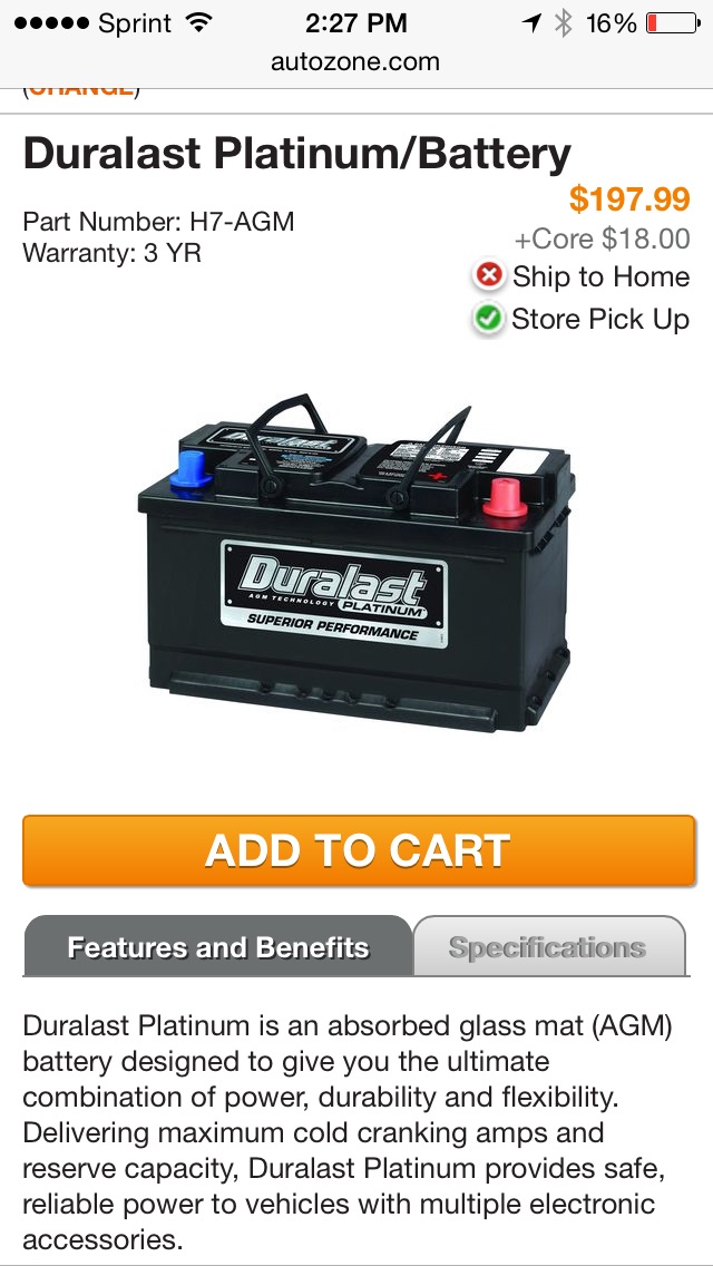

Seems like autozone is selling the Autozone Duralast Platinum AGM for $197 now. Have to wait for a sale!!!
