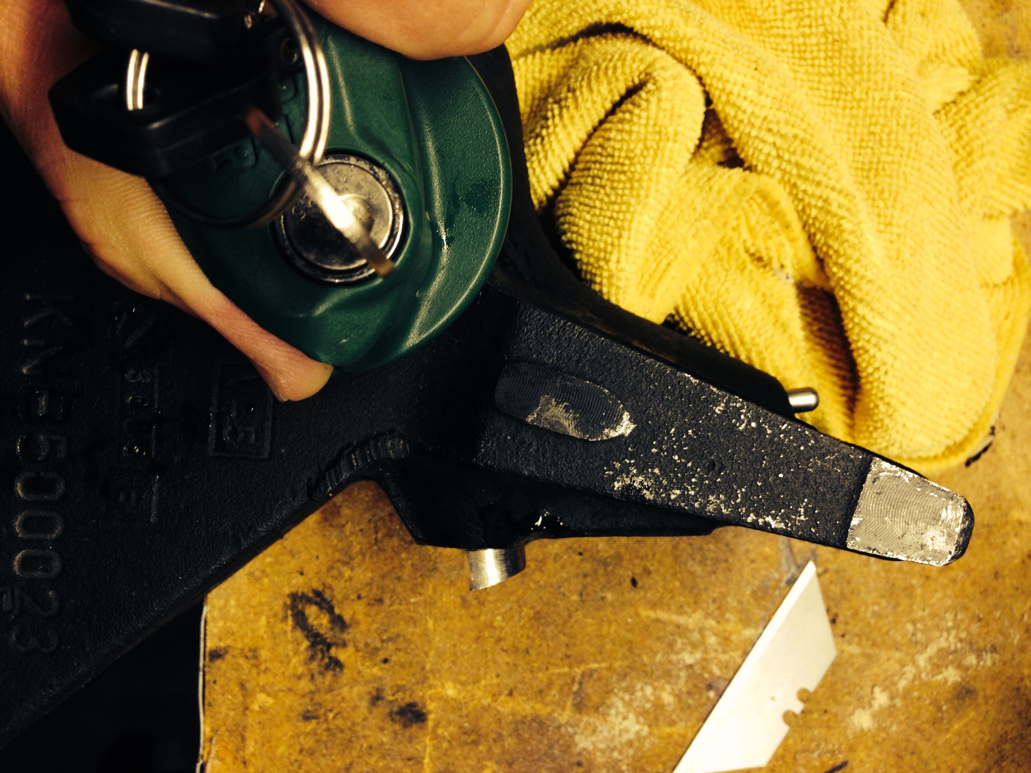

Hi this is my first post to this site.
I bought this hitch off of eBay, and it does not seem to fit. Can someone help me figure out what I am doing wrong? Attached is a picture and here is a link to the video. https://www.dropbox.com/s/m8viqvxrpq2a30m/Video.MOV?dl=0
Thanks for your time!

Knowing what vehicle you were trying to install it on would probably help.
As it is pictured, the locking bolt is engaged, the green knob needs to be turned to retract this bolt, which will then extend by itself once fully installed.
