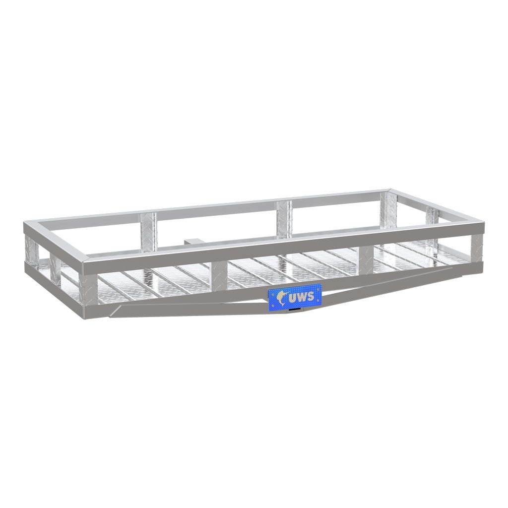

Headed out for vacation tomorrow and this year we're hitting the roads with an extra dog, which means less luggage in the car and more on the hitch tray.
I'm always nervous loading up the hitch tray... especially the way the LR hitch just kind of hangs off the body with that pin mechanism.
So, the tongue weight stamped on my LR4 hitch receiver says 770lbs.
My hitch tray is a well built UWS aluminum model with a max load of 500lbs.
I realize I'm within the tongue weight, but would you be comfortable hanging 500 lbs. off that receiver?
Thanks for any feedback. It's too late to buy new hardware/trays, so I'm making the most of what I have. Perhaps a trailer is in my future.

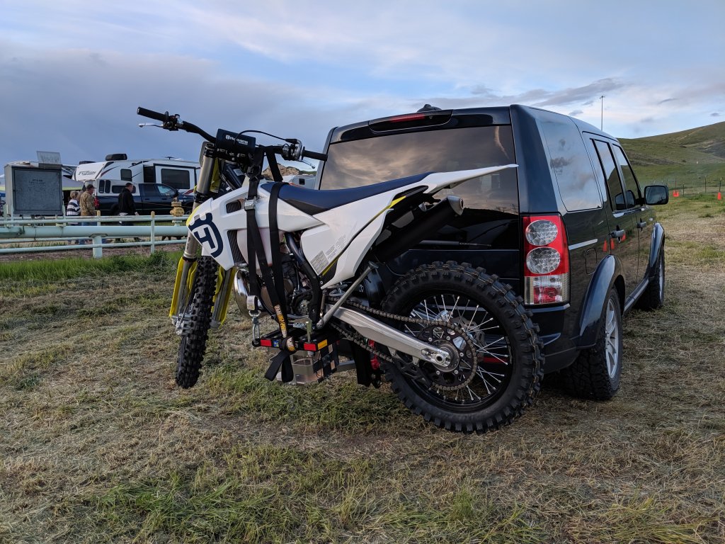

Fwiw 500lbs on a hitch hauler is a very different load on the hitch than a trailer with the same tounge weight. The hitch hauler has way more leverage on the truck and can impart bending and twisting motions where a trailer basically just pushes straight down.
That said I tote a 230lbs dirt bike + 5 gal of fuel on a hitch hauler that itself probably weighs 60lbs, but I use a rhino hitch. I personally would be really nervous doing that with the stock hitch. The truck doesn't seem to notice the weight at all though so no worries on that front.

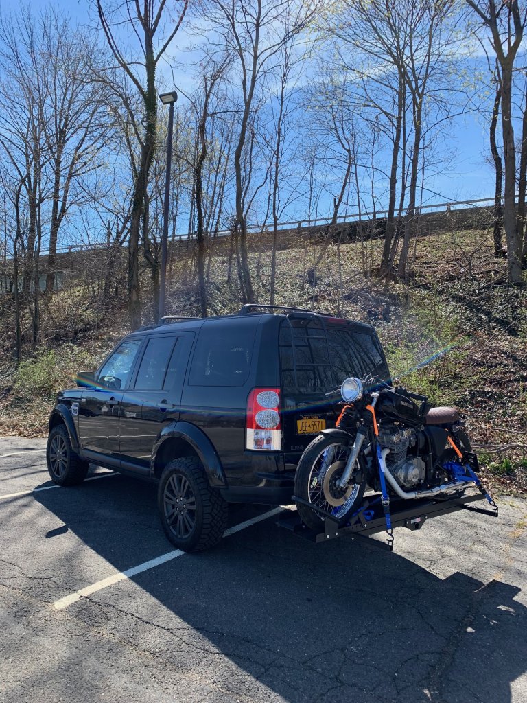

I mount a ~260lb. bike plus a 90lb. carrier on the stock hitch regularly without any issue. I was skeptical at first as well, but have had no problems. I think you will be fine.

For what it's worth, I have an aluminum AWS hitch carrier which I'd recommend. I have had it for several years and used it on my LR3 before this truck. I wanted a strong box, where I didn't have to worry about rust and it was easy to carry and install by myself. This thing has held up and looks as good as the day I bought it. Every time I see those black painted steel ones on vehicles they are usually bent and rusted.
