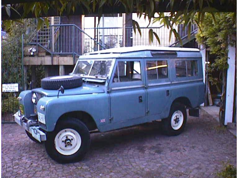

Spare tyre maybe?
Actually if LR put the spare tyre back on the hood, that would probably resolve the latch concern. I do recall however that then the bonnet had to be reinforced to carry the weight of the tyre.
The Series III Land Rover manual cautioned against ordering that particular spare mounting option if "Mylady" was be the primary driver, or at least to bring a "boy" along in the "available" rear jump seat. Presumably Mylady, while delicate, was expected to have some mechanical smarts. This reminds me of Meryl Streep in the movie, Out of Africa.
As to why aluminium, to quote: "The use of aluminium in the construction of bodywork has been favoured by The Rover Company since the introduction of the Land-Rover. The three main advantage of this material are its light weight, its ease of shaping and its resistance to corrosion. The aluminium bodywork of the Land_Rover is one of its most valuable distinctions over competitive vehicles."
