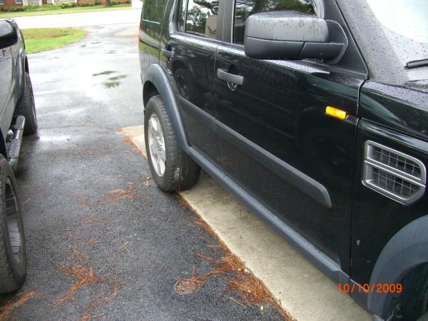

Bad Bones post a pic of your LR3 with the 1.3" spacers. Curious to see.
Bad Bonez BJ
Oct 2, 2009
81
The 1.30" wheel spacer is 1/8" thicker than a spacer that is 1.25" Brought the rear tire out even with the flare at the top of the tire. Still stock GY Wrangler 255-60-18. The 2003 Toyota Tundra to the left has SpideTrax 1.25" Wheel Spacers on it with MotoMetal's Gloss Black Wheels wrapped in GY rubber.
Wheel Spacer without the tire & wheel.
