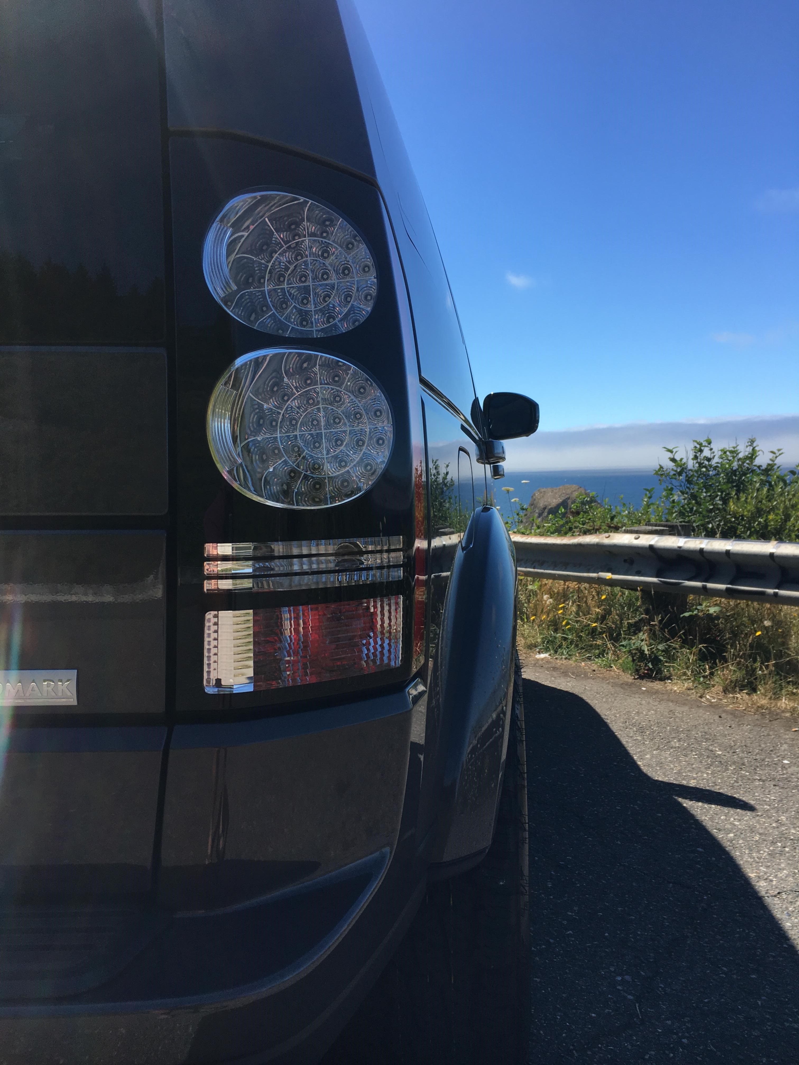

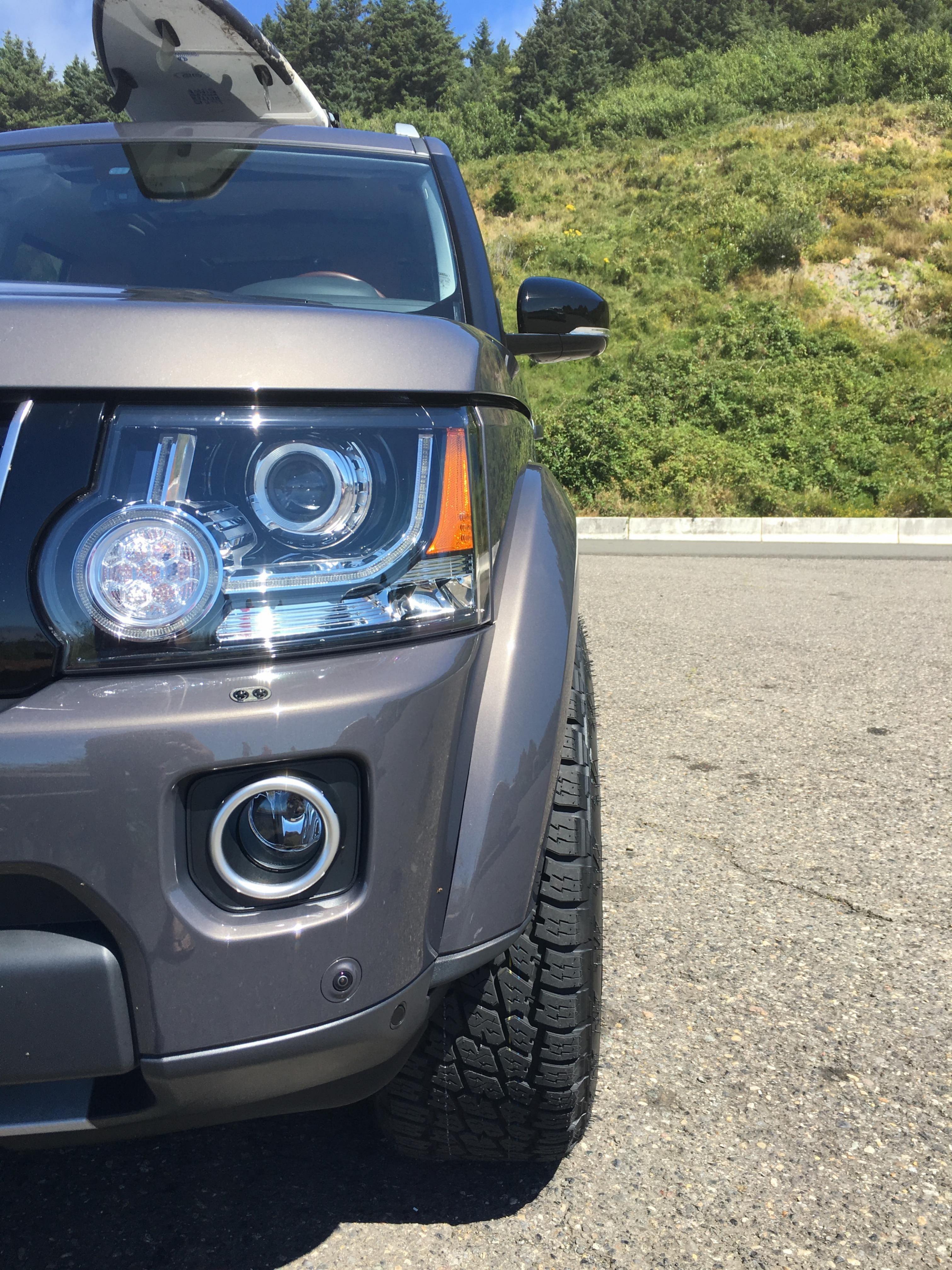

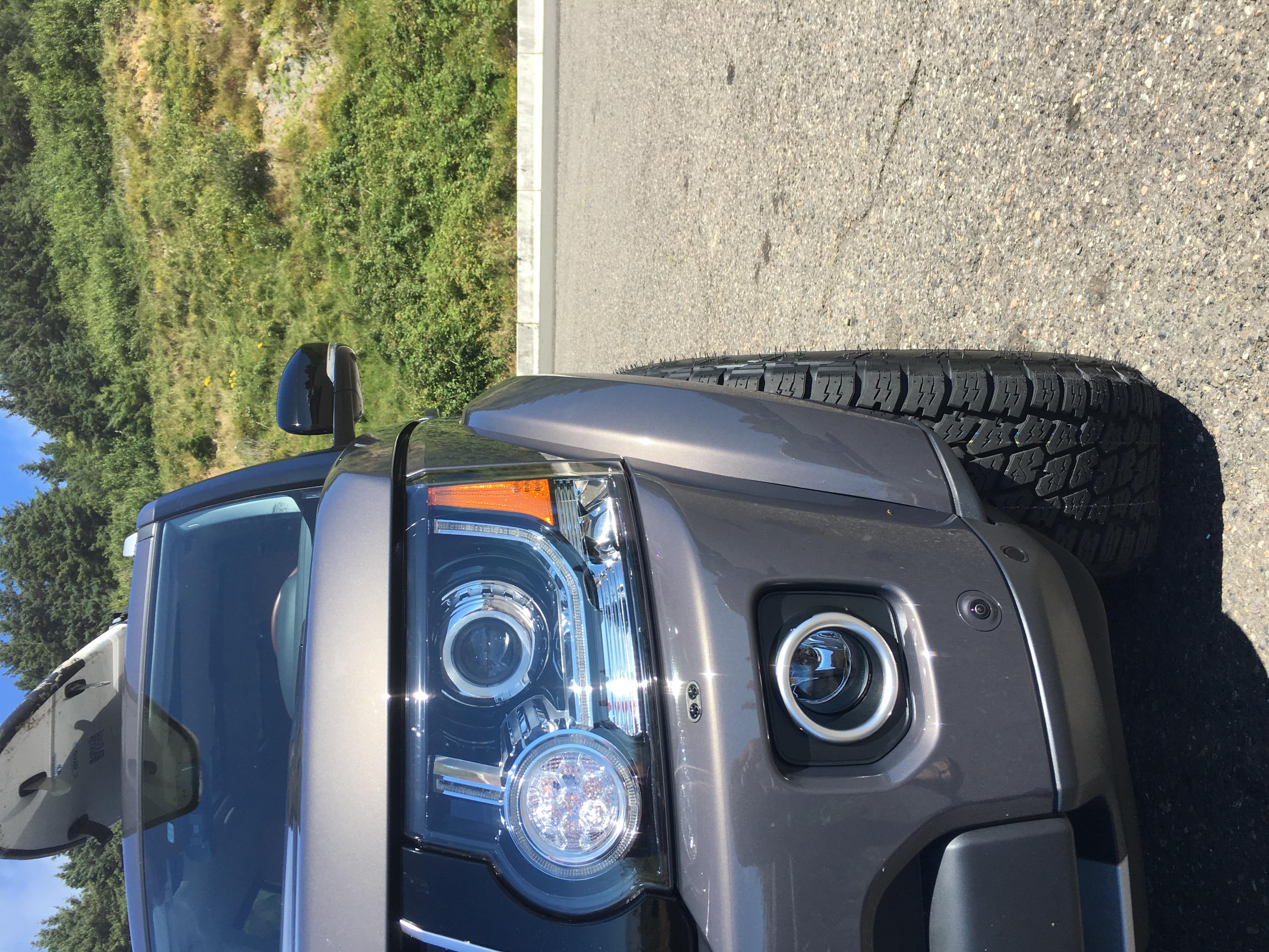

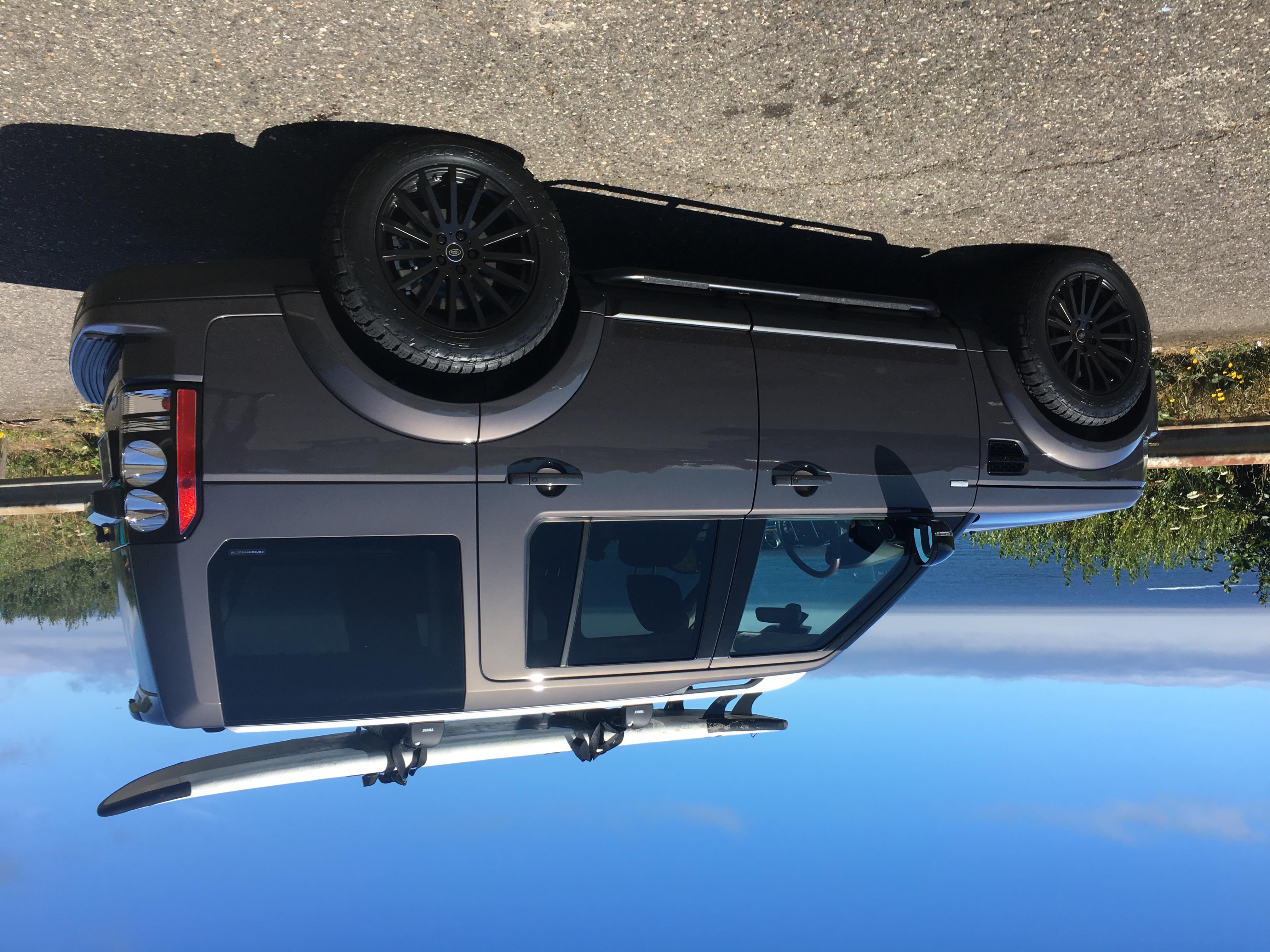

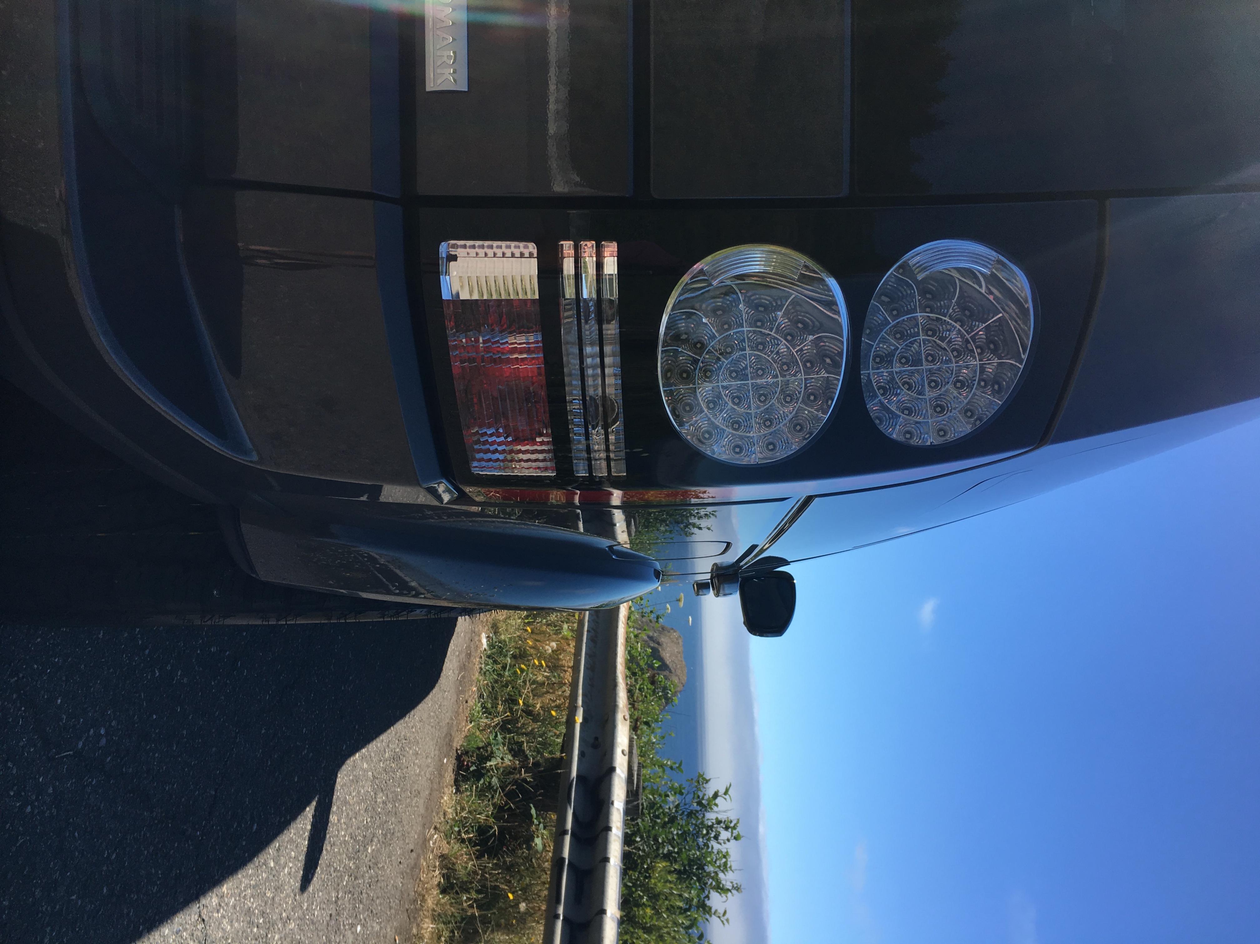

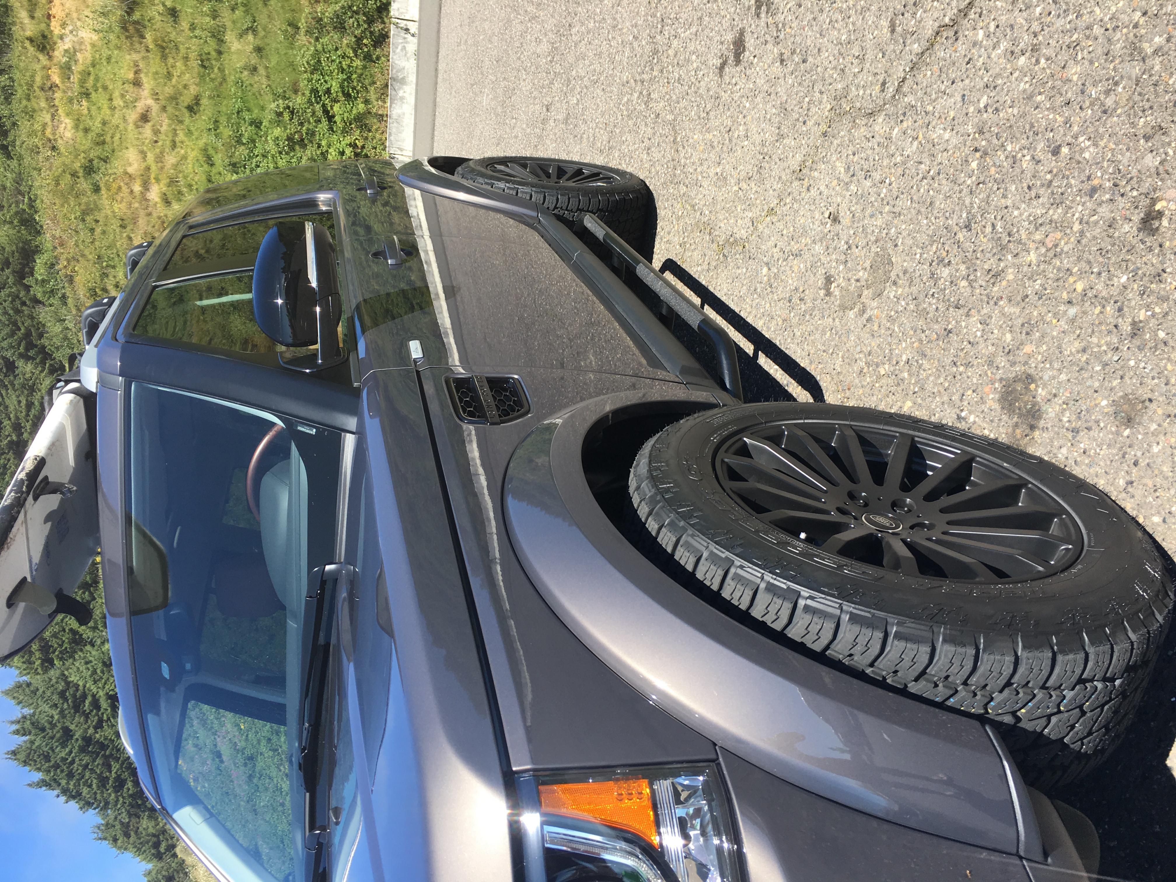

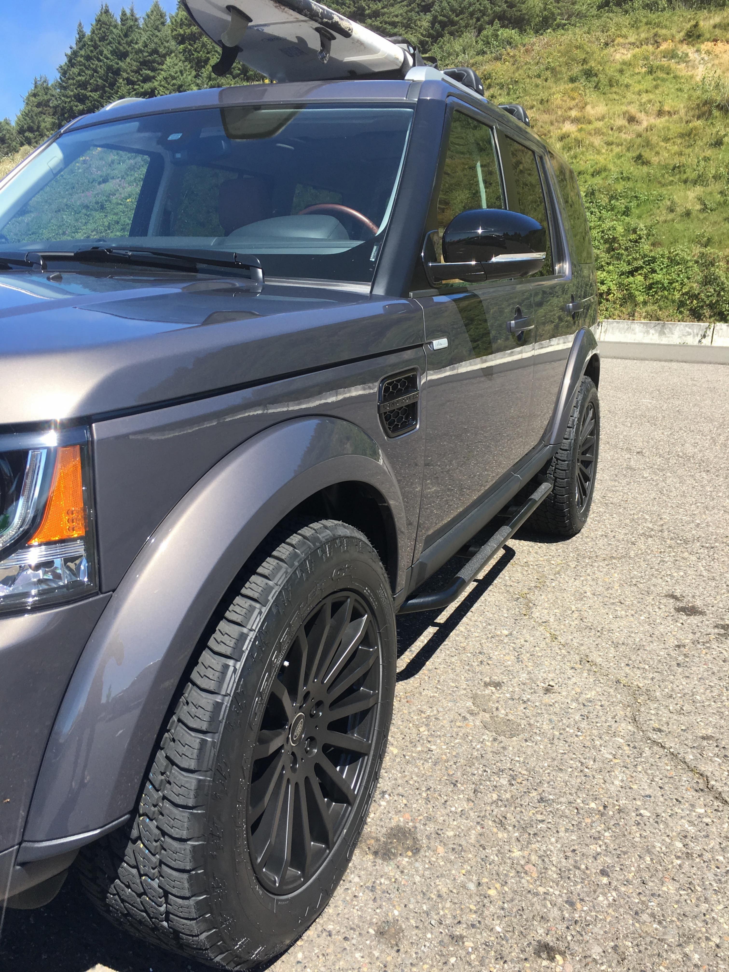

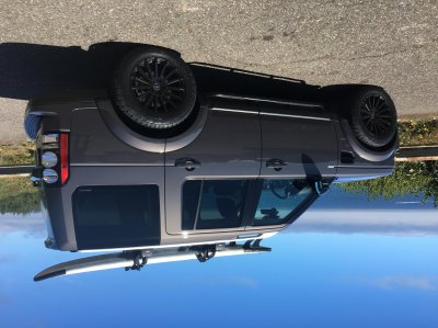

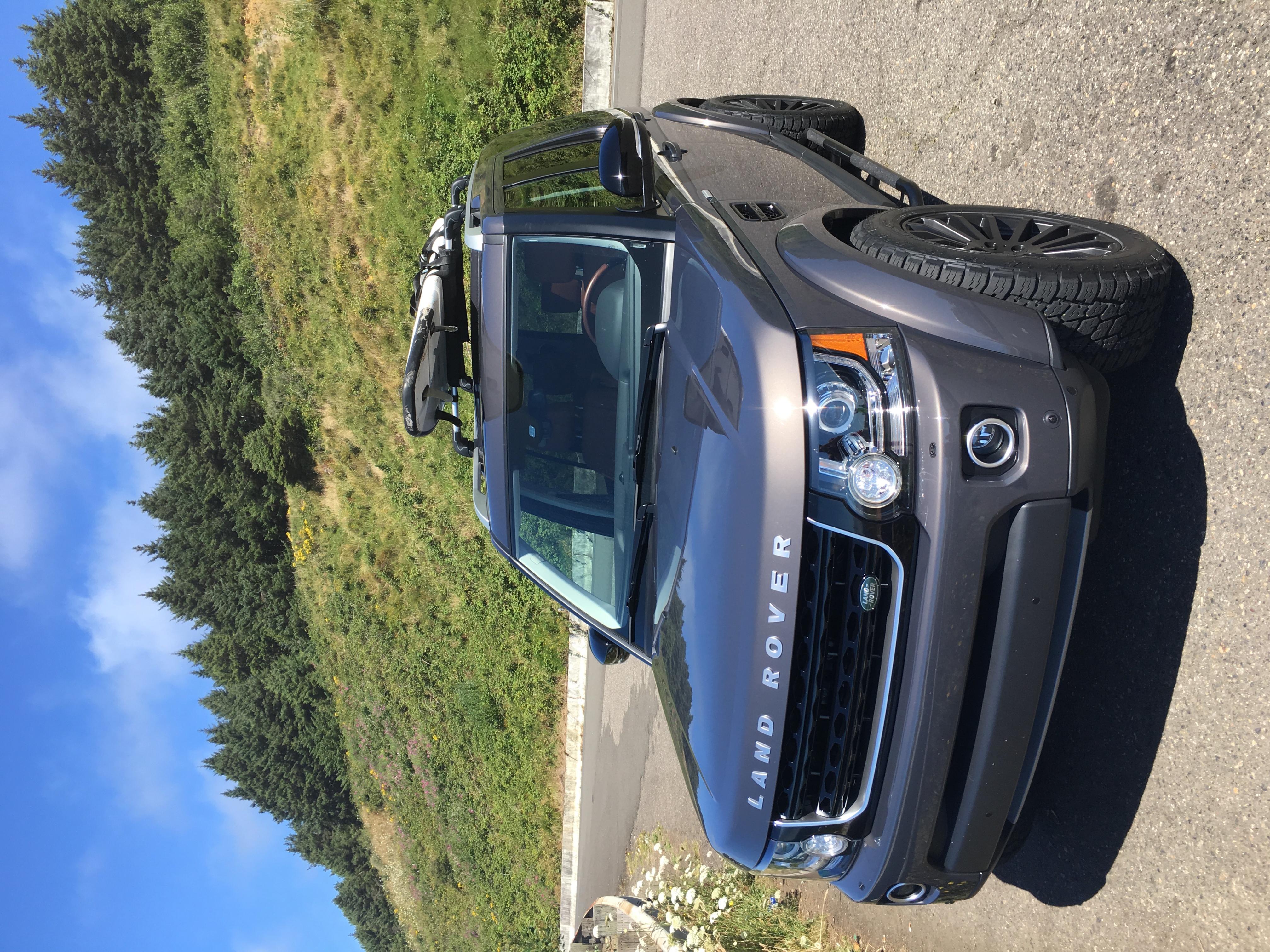

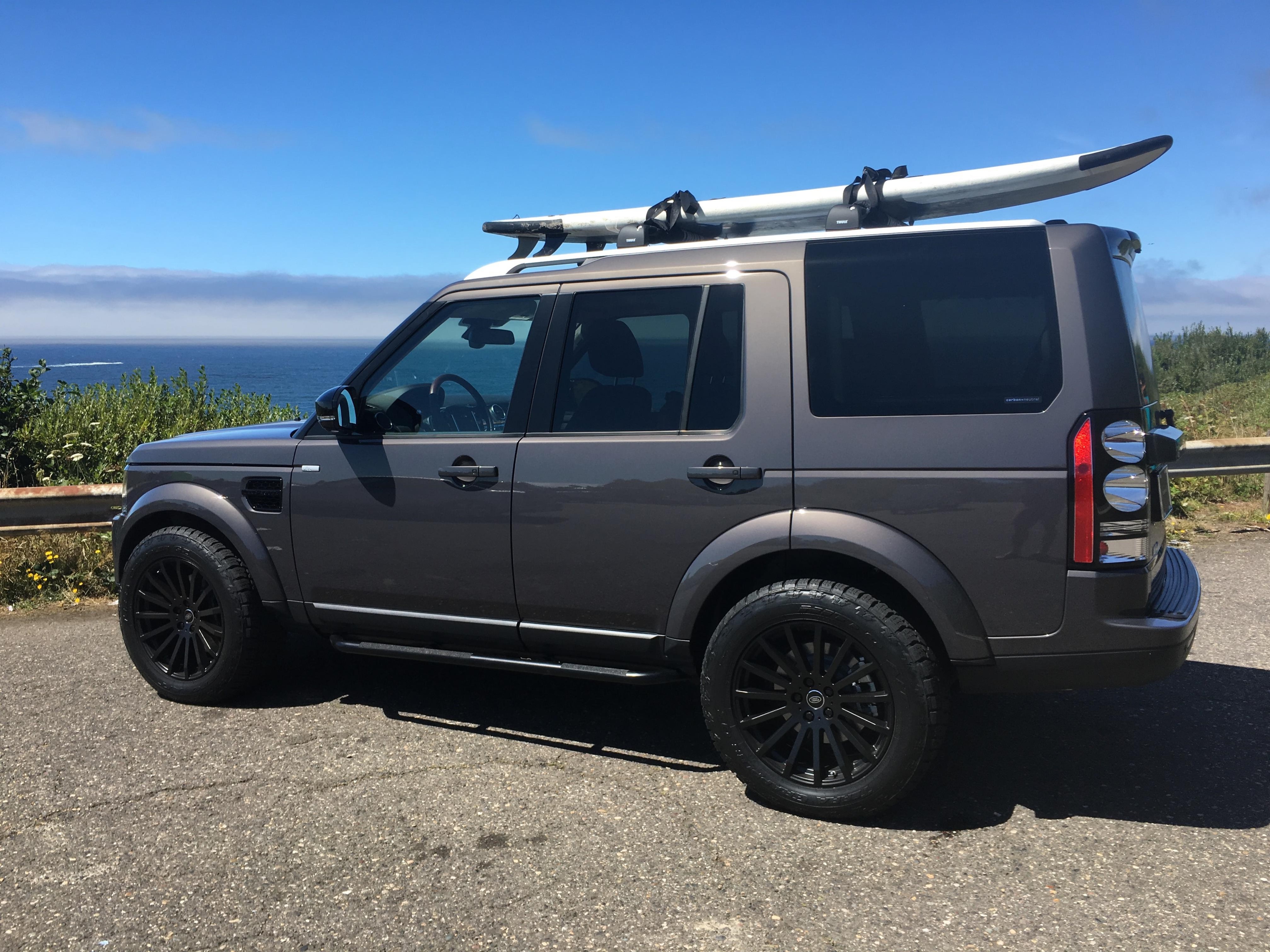

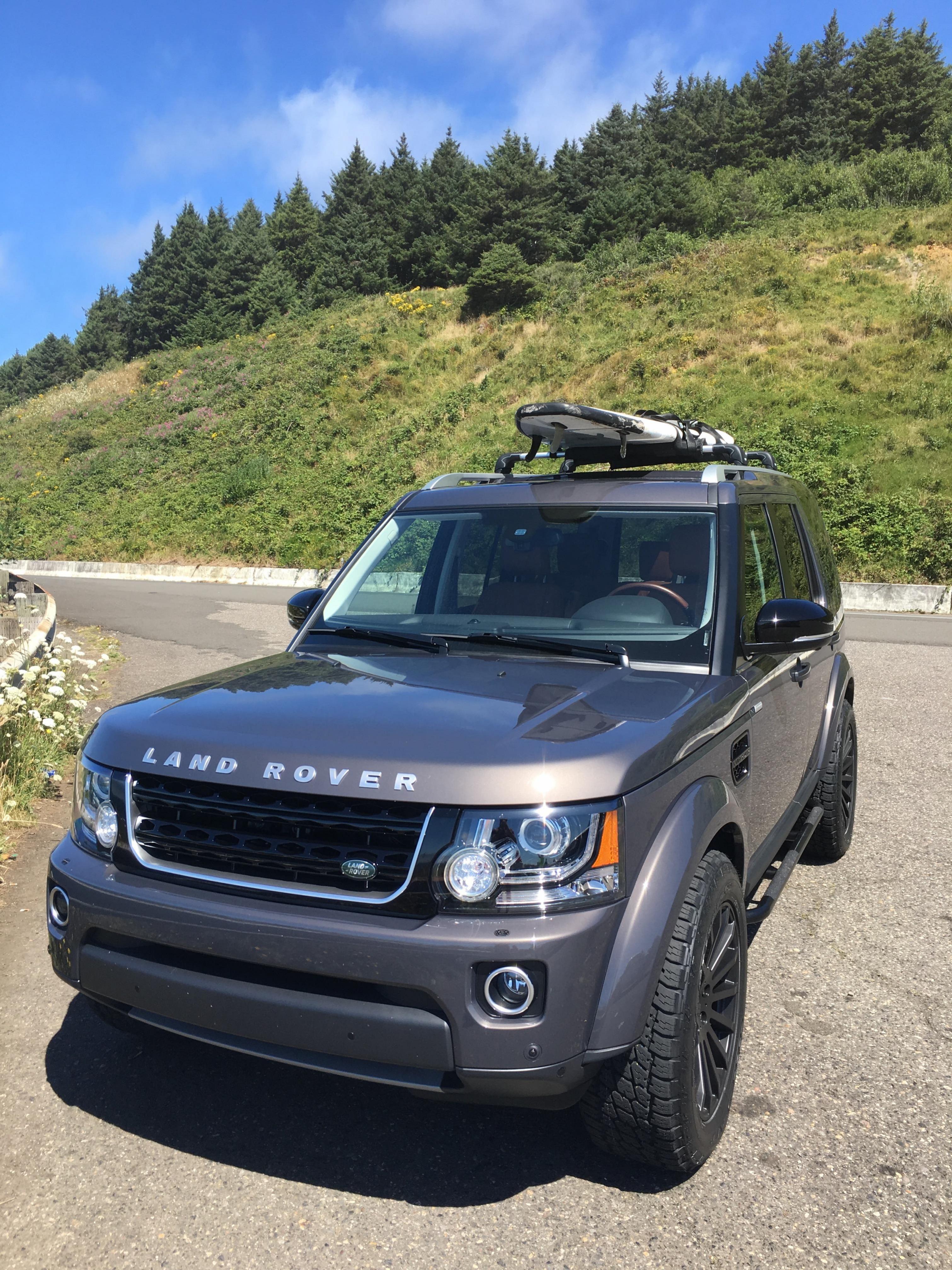

I just picked up my LR4 from the dealer Thursday, and put on my new wheels and tires on Friday. I spent over a month reading through threads on this site and others, with no conclusive reviews on sizing. Regardless, I took the plunge and ordered what I wanted. I couldn't be happier with my results. Here's what I ended up with:
Nitto Terra Grappler G2 in 275-55-20. These are just shy of 32" overall diameter. It's like 31.75" or something. In other threads, there have only been speculations or "I heard this would work". In short - they do work, with minor rubbing. Now - this could be due to the offset of my wheels (+32), but the fact is - the rubbing point is minor at full lock, and the rubbing is happening on the outer edge of the tire, against a metal frame point in the wheel well. My assertion is that a small groove will be marked into the tire over 500-1k miles, and the rubbing will be gone. This rubbing is in "normal" height. It's less in extended height, but still rubs. If I installed the Johnson Rods or similar, it would be gone - i'm sure. But honestly, I don't think I need to, and don't plan to.
This tire has a 117T load rating, at 2833lbs per tire. Well above what came stock. The ride quality is outstanding, and ride noise is only minimally more than stock. The look is head over heels better than stock, in my opinion.
The wheels I went with are the Redbourne Dominius in satin black. Redbourne advertises their wheels as LandRover specific. The weight rating is 2300 lbs per wheel, and they specify use of LandRover OEM lugnuts (got a set of black ones off Amazon). The wheels have a +32 offset, which was the sticking point for me, and took lots of debate. I knew this would have them towards the outside of the wheel well quite a bit. But again, it worked perfectly, even with the 275mm tires. I took a bunch of pics attached, which show from the front and back - the tires actually sit perfectly flush with the fender, and don't stick out. Now, if I had my ideal - would they be in another .5 to 1"? Yes. But that just wasn't possible with the wheels I wanted. My point here is that a +32 offset wheel works just fine with the LR4, and allows you to mount quite wide tires that will sit flush with your fenders.
The other nice thing about the wheel/tire combo is that with a 275 tire and 9.5" wheel, the tire bulges just slightly - giving me just enough rim protection that I won't **** them if I brush a curb. Very happy with this.
Overall, I think the look is perfect. I've gotten more compliments than I can count, and only had the vehicle for 4 days. In my opinion, any LR4 owner looking to upsize would be foolish not to consider this combo. The only downside is the minor rubbing.. But again, I think that's pretty easy to live with, and I do believe it will be short lived
