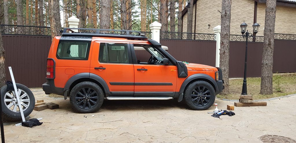

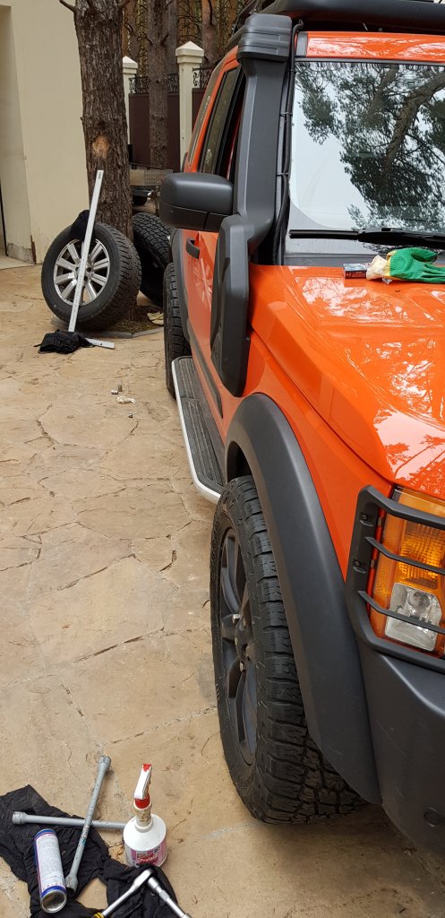

275/55/r20
Nitto Terra Grapper
20"/9.5" wheels with ET18( Et58 wheels with 40 mm spacers)
A lot of rubbing- need to install bigger outlet or lift a car
