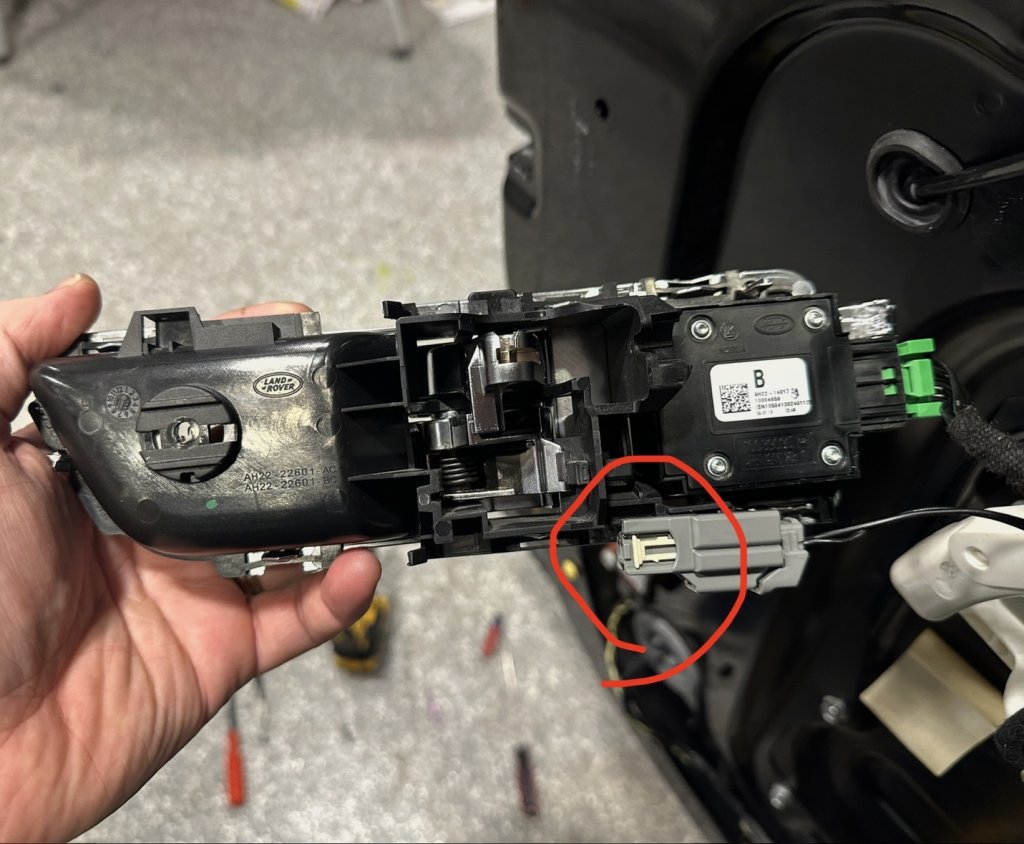

Hi all, my front driver-side interior lock button isn't working and the LED doesn't turn on. Everything else about the locks work great. I took apart the door and it looks like I'm missing a cable. There's this grey cable from the door's wiring harness that goes into a grey connector, but the other side of the connector looks like it should have another cable plugged into it or a wire coming out of it (circled in red).

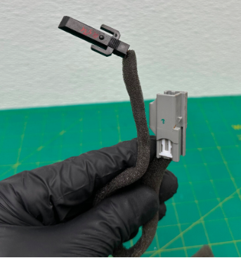

When looking online, I can't find the part number, but when I found the interior door handle assembly (AH2222601AC) on eBay, I found the door handle assembly WITH THIS CABLE (see image below) that looks like it plugs into the grey connector, or maybe the grey connector and the wire are supposed to be one piece/assembly.

Other detail: when the car is powered on, the wire going into the grey connector has two pins, and I measure 12 V across the pins (which ChatGPT tells me is correct).

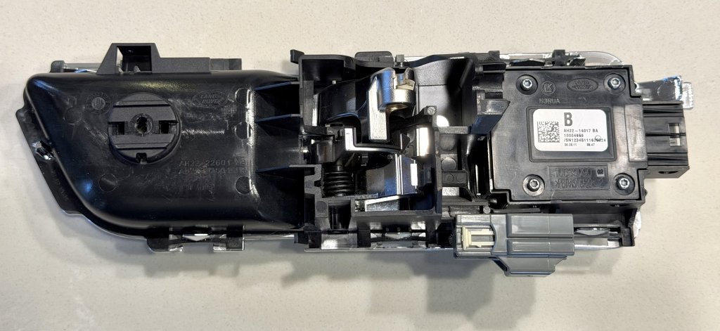

DrPro- Are you looking for this ?
If so, I have one. I'm in PDX.
Let's haggle.

I have that assembly. I have the grey piece. I don’t have the wire with a black sheath, with one end a weird black piece of plastic that slides into the top of the assembly, and the other end either goes into or is already part of the removable grey piece at the bottom. The cable I’m talking about is in the pictures.
