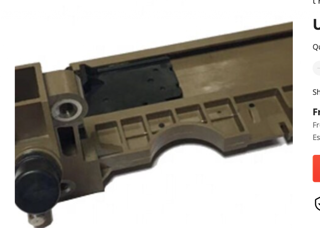

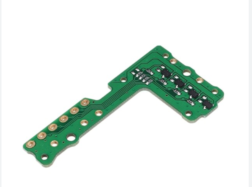

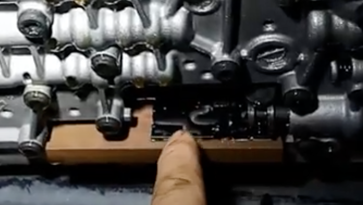

Screen shot of a YouTube video where the guy shows a bunch of metal sludge on range sensor. Also attached if the circuit board that shows 6 soldered round spots. I think the magnet on one side slides along a track, and on the other side of the plastic divider in this circuit board. I think the magnet lines up with the round soldered dot and tells a computer what gear the transmission is on. My theory is that too much metallic sludge might be conducting some magnetism and confusing the 6 Round sensors. Maybe its bridging two pins. SO now I need to know if I should just drop the valve body and do some new seals on the back side, clean the sludge , and reinstall and drive. I guess worst case scenario is Im out some fluid. Also switching to metal pan so it won't be so bad to do it again.
Third shot.....I think the black thing has a magnet in it and slides since it is attached to the shifter via a cable.it slides along the track in pic 3. It slides then lines up with one of those dots on the green circuit board.
