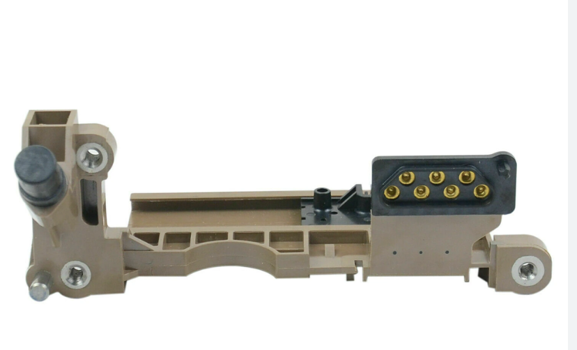

I have a 2011 LR4 with 212,000 miles. ZF6HP26 transmission.Manual shifter, not round pop up one. When tranny is cold it easily shifts from to Park and Drive. The click f the brake release is felt. When tranny is hot, more likely to throw tranny fault when placed in to park followed by "not in park" and won't turn off. Once this happens, there is a chain reaction with faults for brakes, flashing E brake, beeping, no HDC, all of that.
Factory scan shows p0915 and p0850 which have to to do gear selector and park/ neutral circuit. Tranny works fine when there are no codes. This tranny has not been serviced so the first try at any remedy was changing 4 quarts of oil. Just a drain and fill. NO change. Cleaned all connections under shifter. No change. Swapped circuit board under shifter. No Change.
On the black plastic TCM, attached to the valve body, is a small portion of light brown plastic. This is the gear range sensor or gear selector. Looks like it slides back and forth with a circuit board on one side helping the TCM and other modules figure out what gears its in. Picture attached.

1) Can the range sensor every get so dirty, that just a simple removal and cleaning solve the electrical glitch? Wondering if the sliding plastic piece has a magnet in it and can attract junk.
