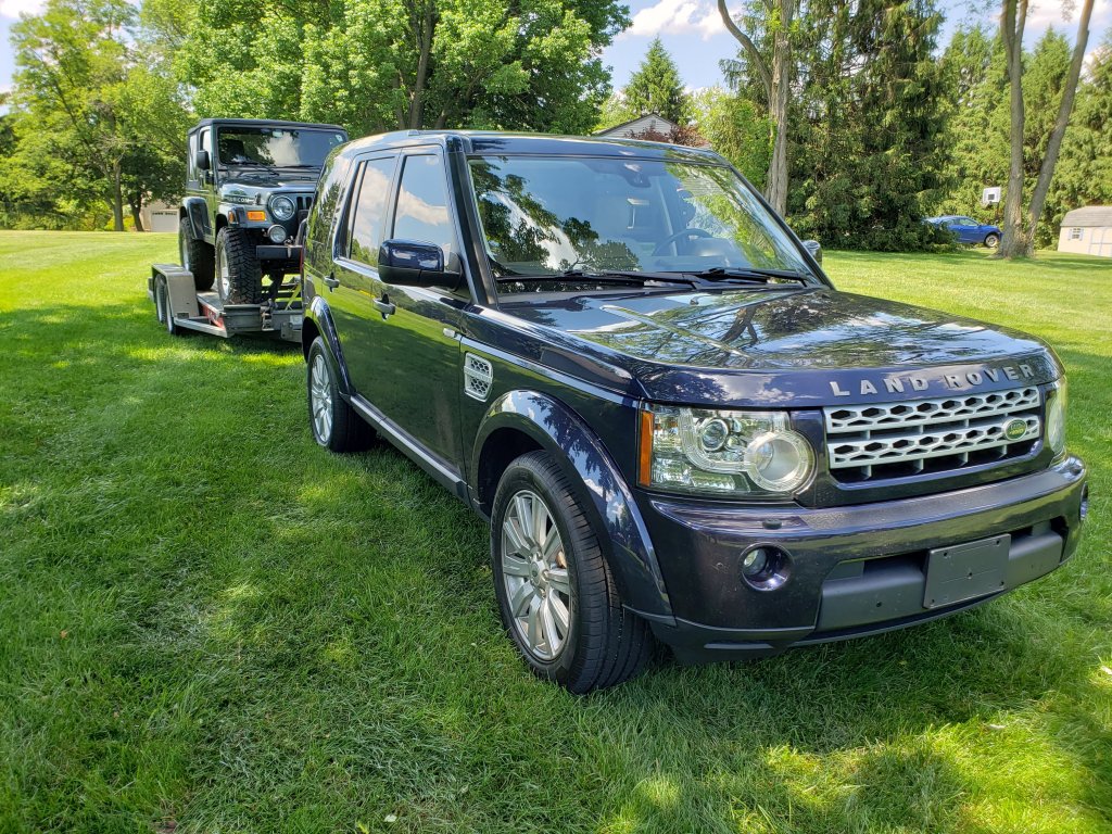

She tows 6000# of non aerodynamic stuff just fine with that V8 torque. Hate the surge brakes on Uhauls but I subsequently got a pickup with a real towing setup and my own trailer for the Jeep adventures.
