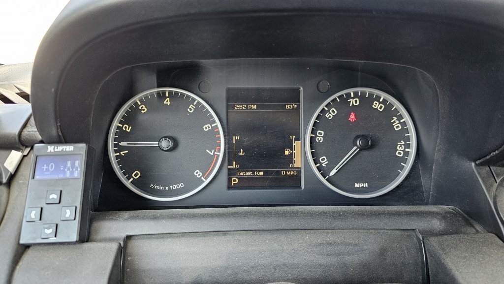

20260418_145415.jpgDon't mind the dust... I haven't cleaned it since our last outing.

Imagine the xlifter as a piggyback to the oem system and that's all it is. I use the xlifter as a compliment to the oem modes as well. If I'm going to use crawl mode, I will put the xlifter back to +/-0 before putting it in neutral, lo gear, and switch to crawl mode. The reason behind that is the xlifter will piggyback whatever the oem system is doing.
If the oem system is in +55mm for crawl mode, and I add another +55mm with the xlifter it WILL fault and error out with "Suspension Fail". However, if I need another (max up to) +20mm with the xlifter while it's still in +55 crawl mode I can do it without issues.
Another thing to add is that the xlifter can put the truck at any desired height without the oem suspension lowering itself if you reach 30 mph.
