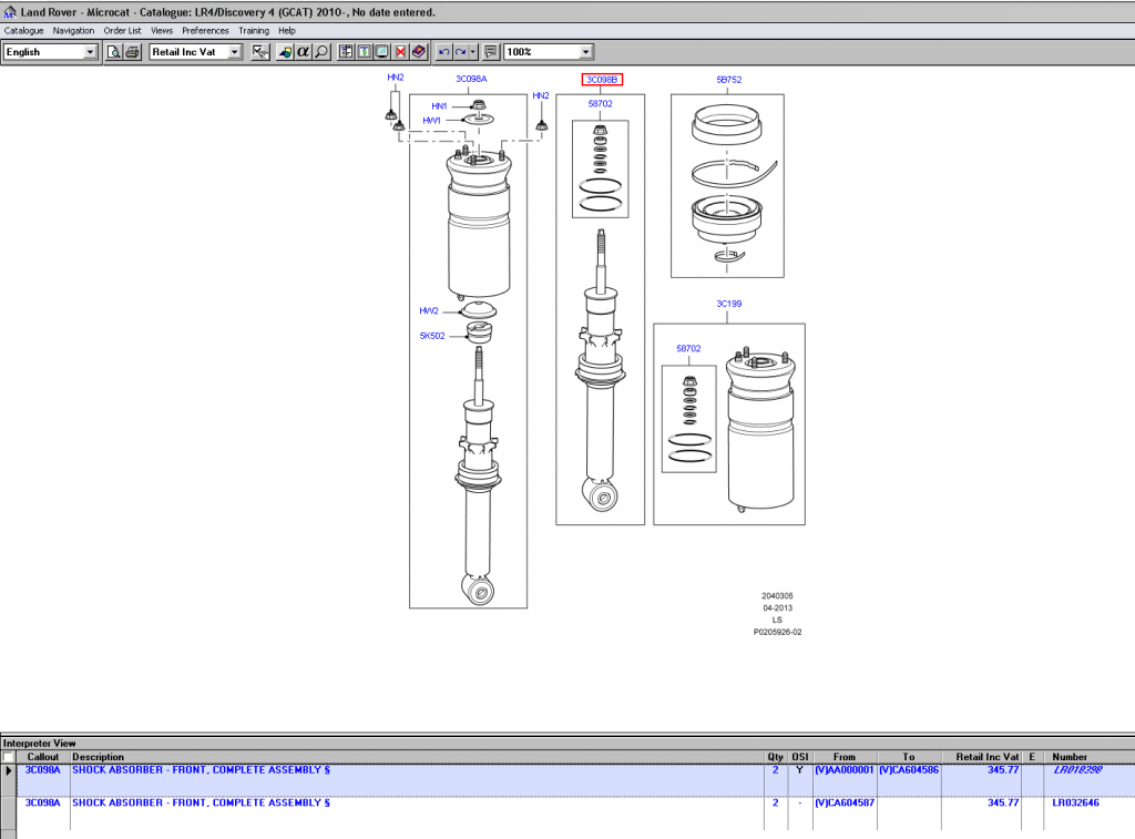

The shock absorber portion can be replaced separately from the air spring. I did not know this. See Microcat screenshot below.
However, the pricing doesn't make this cost effective. The new air spring assemblies complete are about $1350/$1600 MSRP front/rear, respectively, for Genuine LR at the dealership... or about $1000/$1200 from discount dealers. Aftermarket assemblies from BWI, allegedly OEM, are only about $450/$550 for front/rear, respectively.
@powershift, your shop quote for OE/Genuine air springs was reasonable, but IMO the $2.5k labor was not. Ten hours at $250/hr? Nope. Google claims 4-6 hours for all four is typical, times a reasonable local labor rate.
The shocks separately are about $450/$400 MSRP for Genuine, $375/$325 from discount dealers, maybe $250/$350 for allegedly OEM (hard to find OEM bare shocks - lots of places are showing complete air springs super cheap from no-name junk brands).
So, $250 for the bare shock vs $450 for a complete front OEM BWI air spring? Seems the full assembly would make more sense most of the time, like for my rig with 167kmi on the originals. Pretty likely if I installed new shocks, the air spring would fail shortly afterwards.

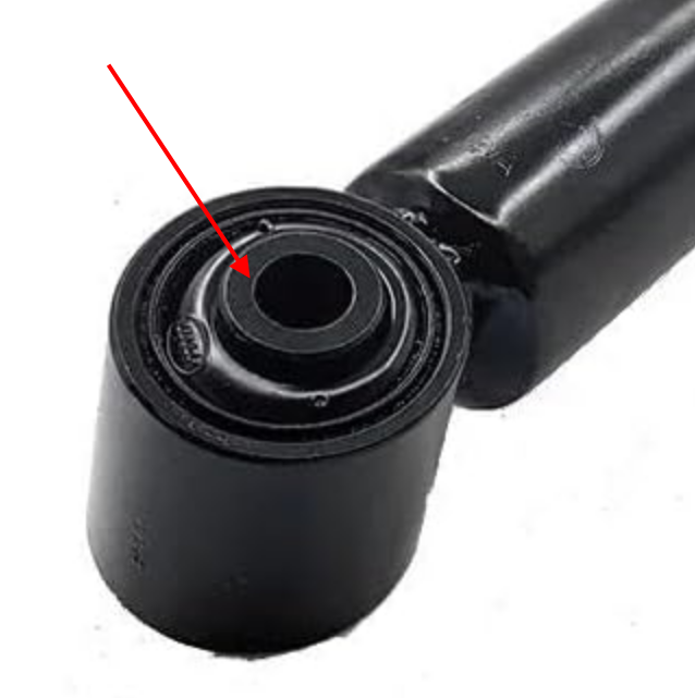

On the plus side, the lower bushing definitely appears to be replaceable. The trick is finding a suitable aftermarket bushing to press in. And, all the labor to swap it out. This assumes the lower bushing is the root cause of the noise, and that the clunking is not internal to the air spring/shock assembly.

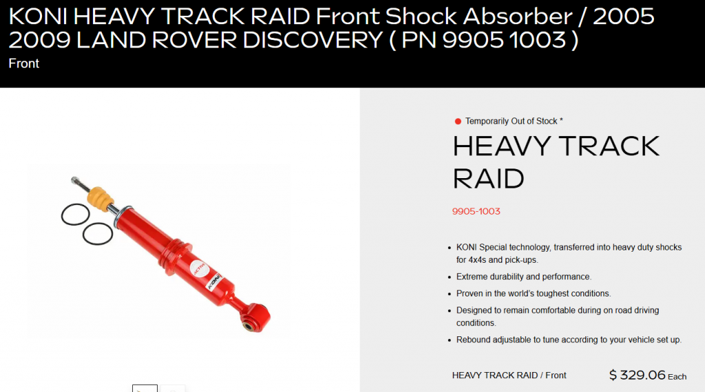

Koni make a frequency sensitive damper for the LR4, but other than knowing it exists I have not found any reviews.
gsxr
May 8, 2017
811
416
Big Sky Country
Adjustable rebound it says. I wonder how its adjusted?
I have KONI dampers on other vehicles. When the top of the strut is accessible, there is a tab that protrudes from the center of the shaft and this can be rotated to adjust.
For dampers that have both ends attached to something (like a typical shock absorber, separate from a coil spring/strut assembly) the damper must be fully collapsed and then the shaft rotated to adjust. This requires removing it, adjusting, and reinstalling. I assume this is what would be needed for the LR4.
