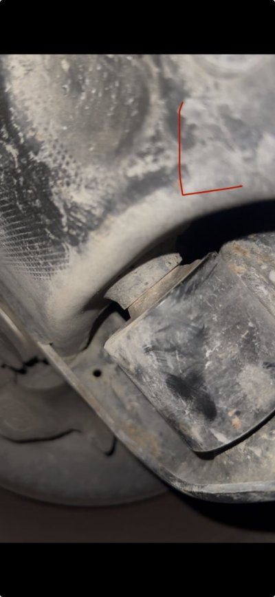

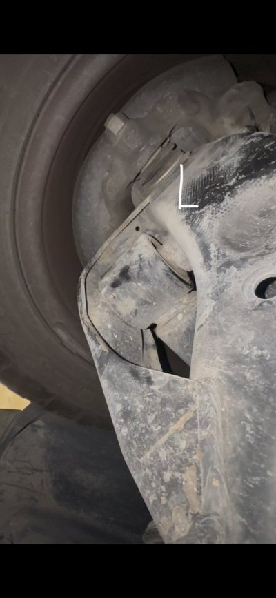

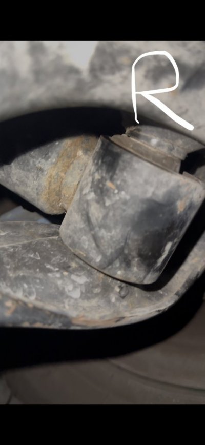

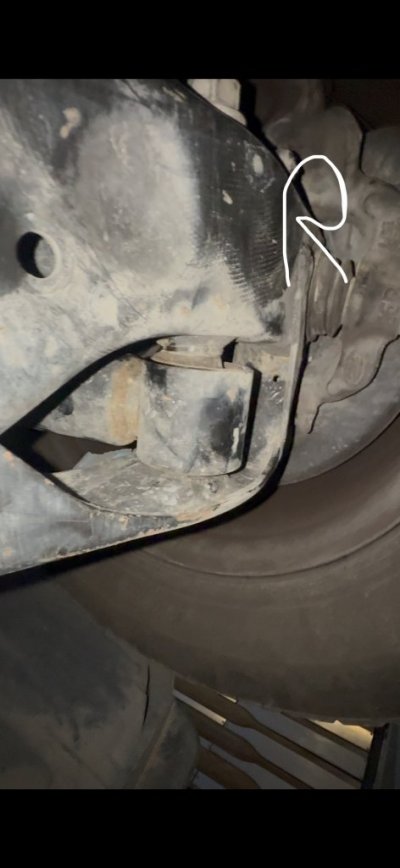

Got the truck up in the air today and couldn’t feel any play. Took a look underneath and the right strut bushing that connects to the lower control arm seemed to be a bit more crunched compared to the left so I put it in off-road height and took a look underneath and the bushing seems to be collapsed. It’s hard to see from photos but I’ll link a couple. From what I’ve researched this is not a serviceable part. Would hate to replace a whole strut over this small part.
I’m running aftermarket arnott struts but has anyone seen this before? Let me know if it looks collapsed.

That does look highly sus. I wonder if there's any aftermarket bushing that could be pressed in to fix this? I agree, seems like a waste to replace the entire strut for only a worn bushing.

Yeah, I plan on looking into it as soon as I get some confirmation from here that the bushing does seem like the culprit. I'll try to reach out to arnott directly and see if they could help me out and just send me a replacement for $$. hopefully a shop wont charge me too much if i give them them strut itself and the bushing to press fit it.
funny enough the noise is still there but significantly less prominent now that i lifted the car up and set it back down on the ground. wonder if relieving the pressure helped the bushing settle a bit. I'm sure it'll come back in a week though.

So I did a bit more digging and decided that if it really was that bushing I could icolate it by lowering the suspension with the IID too and then putting it in access high to minimize movement in the actual strut itself and when I drove over the same bumps it barely made the noise. Put it back into normal height and it made the noise a lot more, so I do think something internally inside of the strut (most likely the dampening mechanism) has failed or is beginning to fail. The car still rides fine so I guess it’ll go on the list of summer maintenance. I still think it’s crazy that my rear air struts are original with 160k miles on them and now this will now be my third pair of front struts.
