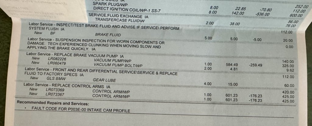

Adding my two cents on this topic. I just had my LCA’s replaced on my 2012 LR4. March 2025. I paid $1270.00. Replacing lower control arms is pretty straightforward and any competent mechanic would be able to do it. I would not worry too much about it.
