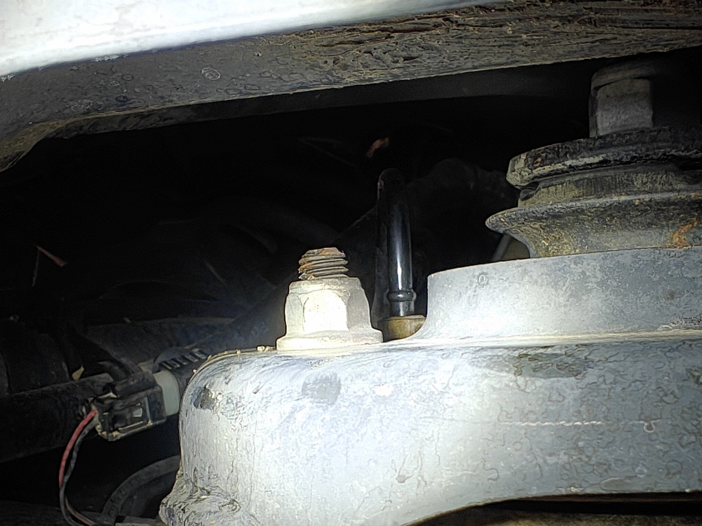

I'm looking to replace the brass air line connector in the pic below. It mates the air line to the air strut. The dealer gave me PN LR044836 for $69. Price seems right for a brass fitting (j/k) but the part doesn't look right https://landrover.oempartsonline.com/oem-parts/land-rover-connector-lr044836 I looked through the catalog and didn't see it for sale.
Do I need to buy a whole air line, much like if someone wants a coolant fitting we need to buy the whole line and connector as an assembly?
if you really think its the fitting i would try tightening it first. had a D5 that would sag on one side and ultimately take the other side with it. found that the brass fitting was leaking, tightened it and boom, no more leak.
Evidence shows that the fitting is not leaking because both L&R rear sides dropped together with the battery unplugged instead of just that one corner. I didn't know that before but I see reality now.
I'm thinking about taking apart the rear valve block and cleaning the O-Rings, seats, the valve mechanism and other surfaces. If the components are all cleaned and not worn/broken then the inspection is complete at least. Maybe the air is escaping past the O-Rings and out the case of the valve block.

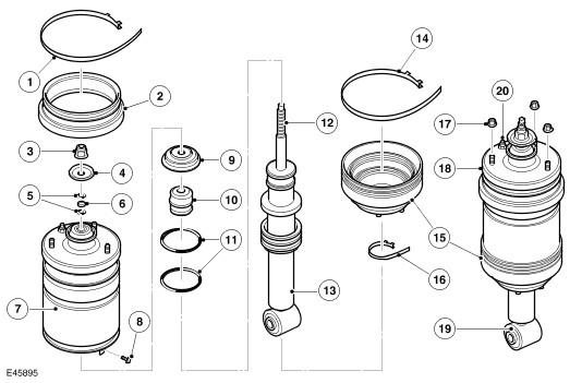

Fwiw, the part the dealer was offering LR044836 was #18 it looks like because #20 is the VOSS connector.
